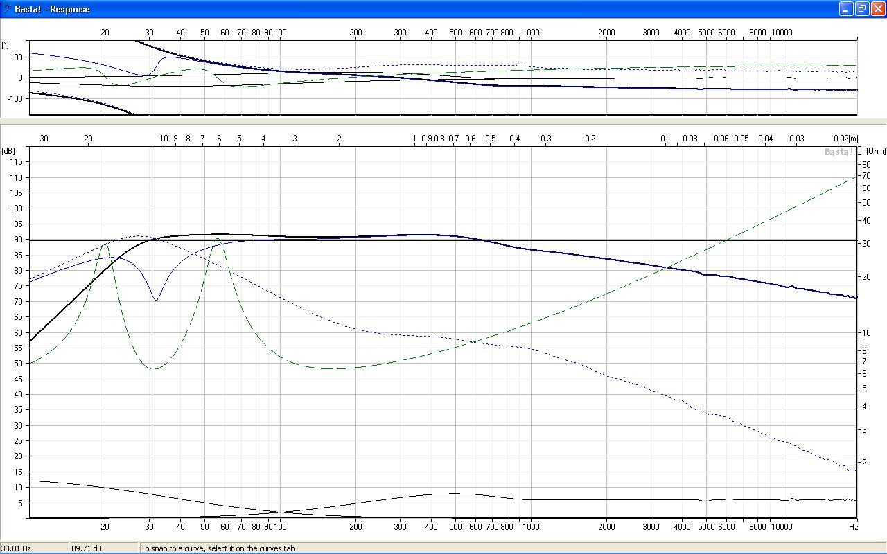

This is what I'm planning on doing. It's a B&C 15BG100 in a 80liter box tuned to 32Hz. Sensitivity is a little above 90dB, and it's good to 30Hz with room gain.
