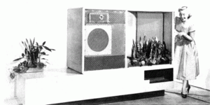

GM
Jensen Imperials?
Yeah, 30 ft^3 cabs is a small price to pay for high def music and to fill in the bottom end, a tapped TL to do double duty as a base for it. ;)

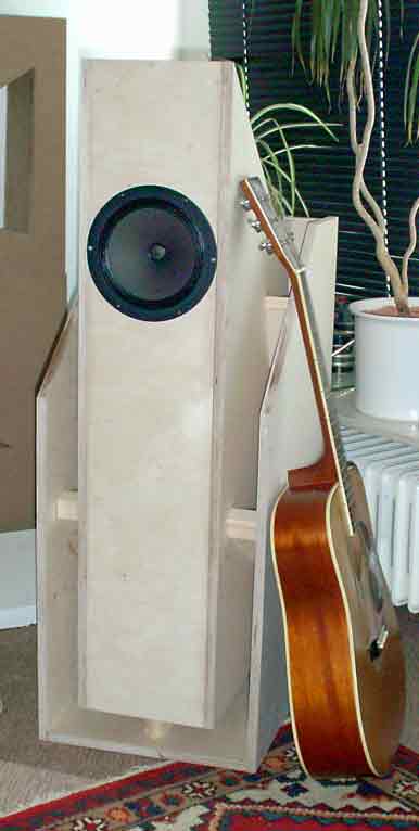

If you will high eff. and low cost, and specially you need for the Tube
a very linear impedance than look at my horn constructions:
POSAUNE XL, RDH 20, SAXOPHON with measureements and feedbacks,
in your case a Schalmei sathorn with one aktive sub with sat crossover
for your tube would be enough in your small room:
posaune
saxophon
RDH
