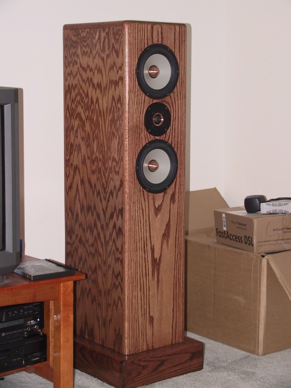

WolfmanX said:
I am thinking of laminating the entire cabinet in 1/4" or 3/8" cherry and sanding that down and adding a neutral stain and urethane to finish.
I didn't know if it would sonically harm the originally intended sound.
One of my buddy's (ChrisB) favorite finishes:
He did up my pyramids in cherry. They look way better than when raw, but don't sound quite as good. I have to go in and add a few braces to push the wall resonances back up. I have some other (radical) mods i'm going to do as well -- inspired by the beautiful expanse of cherry on the back and the availability of some 6" PVC pipe.
