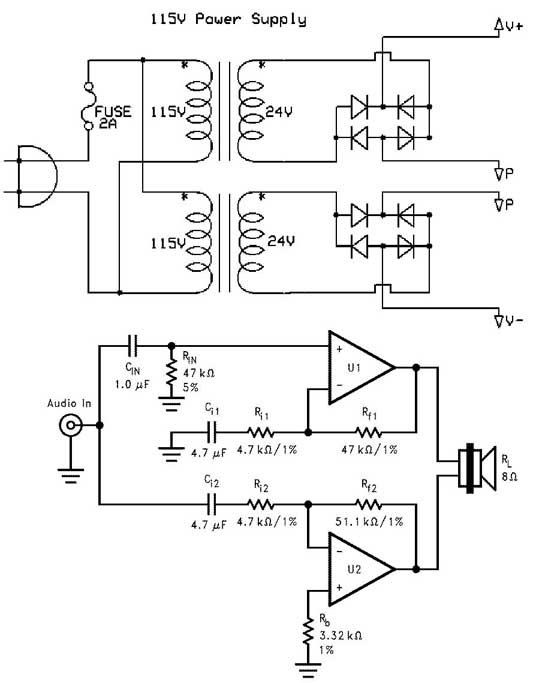

Ok, I've built a bridged 2x inverted LM3875 sub amp following National's tech notes for bridged amps . It works OK on the bench w/ a junky speaker I had lying around, can't really crank it up because the speaker is not a woofer and it distorts like crazy .
My problem is I have a 315 mV offset voltage Ouch!!
Question, how does this manifest itself in the audio, and
Which values would I have to tweak to get rid of it? I followed the values shown within about 5%. ( the toleance of my ca$75 multimeter) Can I place a trim pot in series w/ one feedback resistor and adjust?
