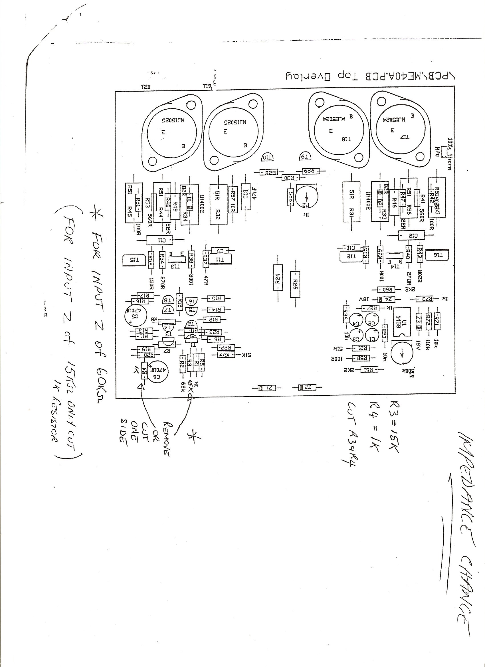

...well,Peter Stein spent some time with me instructing me on changing the Z-value to 68K on the ME550 ... now its much more compatible with more pre-amps...
...quite a helpful fellow...Its just a matter of snipping 2 x L/R resistors and reversing the polarity of the red input channel. You have the option of having the ME550 running with a input Z-value of 1kohms, 15kohms or 68kohms - depending on which resistors you snipp...

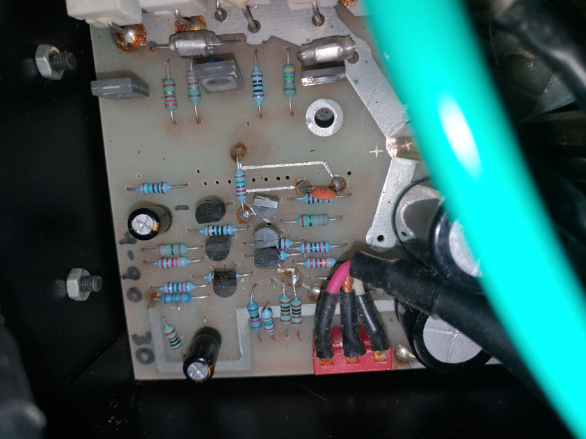

That sounds like a good idea. This is for the ME550 Series I. This is what I did for mine as per instructions and it worked for me. (NOTE: Do so at your own risk or consult further with an ME technician)
First clip the relevant resistors as per diagram (see attachment) depending on whether you wish to have Z-output of 15Kohms or 68Kohms.
You find the exact spot for one side of the amp; clip those resistors (see photo) and then turn the diagram 180 degrees and do the same on the other side in the exact same spot.
On the red input plug, the red wire on flat plug (from circuit board leading to RCA input plug) has a white line on the side of it, and that should be reversed so that the red wire with white line plugs into the part of the circuit board markings (180, E, 0) where it is plugged into, is '0'. This is also verified by ensuring the green dot on the flat side of the plug is facing the chassis of the amp (see photo)
(On the black RCA leading to the flat input plug on the circuit board, I noticed the red wire with white line on the side of the flat plug going from circuit board to RCA input plug was at '0', and it appears it should be there by default. I did not see a green dot painted on that side however. I don't think there was meant to be one there for the left side as it is on zero already, however I checked to make sure).
An excerpt attached as pdf from the manual called 'Wiring for Common Earth Systems' explains things more.
...as I said - this is what I did per instructions and it worked for me ...

Peter Stein also said when I asked him about any possible degradation of sonic quality if the Z-value was changed to a higher value ie 68Kohm:
"Sound quality has more to do with how the input of the amplifier gets its signal - the standard arrangement optimises both cable and environmental issues (as long as preamp driving it is commensurate quality and performance as I previously mentioned).
Sound quality may be degraded if these issues are affected by less than ideal factors - one will be that cable quality will be much more influential, and how the preamplifier (if more than a few hundred ohms output Z) reacts to both the cable and the environment (read interference of various kinds) - this is outside the influence of the amplifier input, as the amplifier really can't fix damaged audio - it just amplifies what it sees!"
...and
"...no sound degradation from the amplifiers perspective - just the presentation of the signal - the potential and effective issues are outside the amplifier.
Adding an output transformer is a poor choice as transformers add significant distortions and will almost always pick up noise."
...and
".... If you don't like what you are hearing - even after significant experiments - I would suggest you know how to go back to square one"
