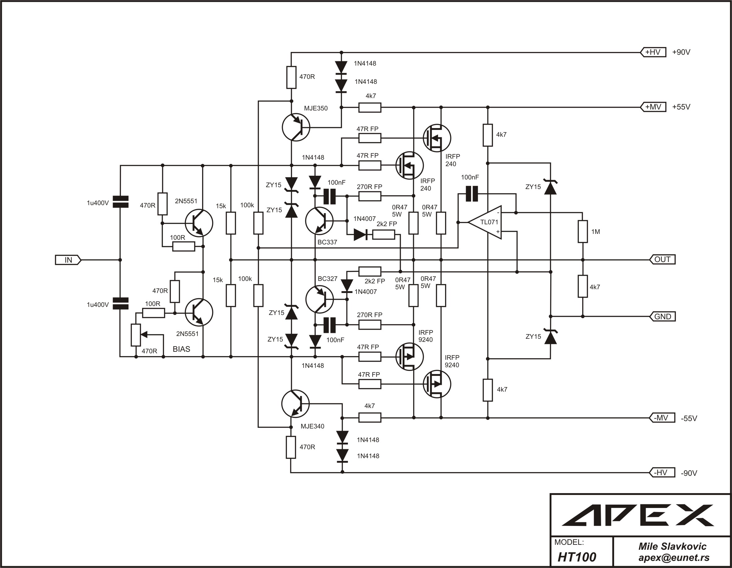

Output stage from Tube/Mosfet Amp

Thanks Apex - what am I looking at here, it looks like source follower but with something going on in terms of bias - is this an auto-bias or error correction ?
