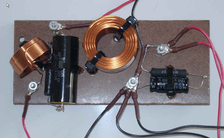

I like 1/8" hardboard. Layout componets as tight as possible, drill a few holes where needed to mount components, strap down components with wire ties. DONE. The back surface of the hardboard is raised off the enclosure surface by the wire ties, one screw in the center of the board is all I use to secure to enclosure wall. I never hear anything from my installations.
