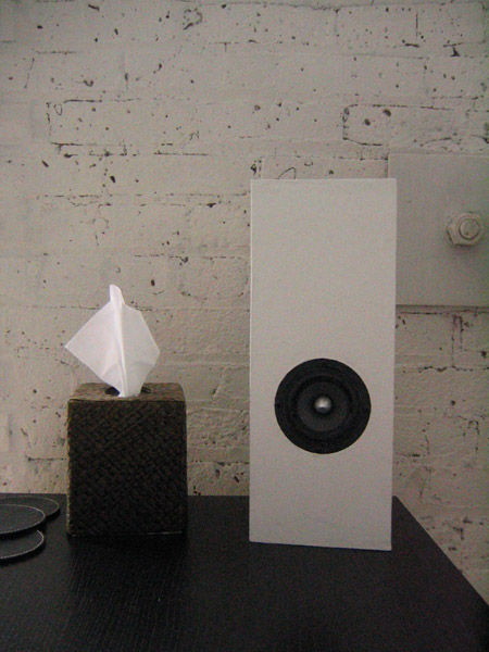

I'm in the middle of my own first project using TB 1364SB "bamboo" 3" drivers as satellites in a folded tapered TL. So far the L/R/C are done, and - though I can't claim to have any serious audiophile credibility - I couldn't be happier. They even sound OK without a sub. WAF has been very high with these too.
One thing about the titanium version is that it has a smaller Vas, so you can jam it into a smaller cabinet if that's important.
Try your hand with MJK's TL spreadsheets, you'll impress your friends and enemies with how much bass you can get out of a 3" driver.

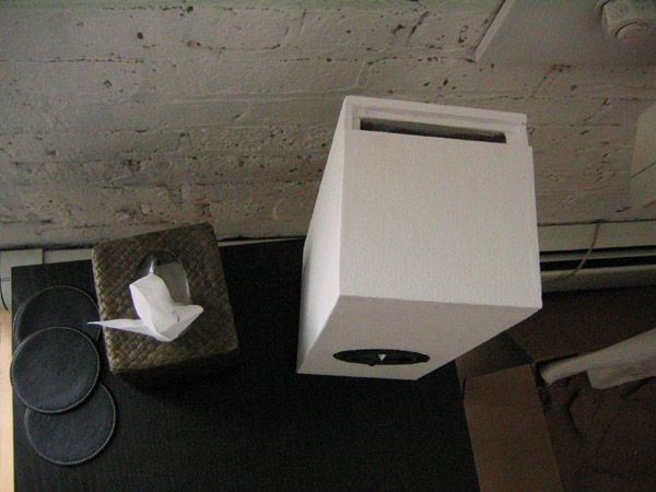

Oh, wow, thank you. I don't have much belief in my carpentry skills but I'll try to attach a photo of one of the finished satellite speakers. There is a tissue box next to it for scale, and behind it is the wall that soongsc mentioned. :) By design these cut off right around 90Hz for use with an HT receiver and sub.
I'm still battling the PE speaker mounts but will get this one up on the wall next. Epoxy can a wonderful thing.
WAF was also a factor in the design. My wife wanted white speakers for the white wall and threw up all over the idea of veneer. I used sanded white paint to cover the evidence of my bad woodworking.

Another view:
