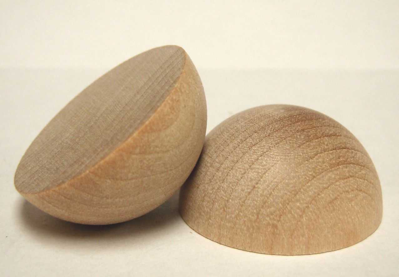

I bought these from PE, part number 240-698
They are adjustable and have a flat part to avoid damage to floor. I'm making a slightly wider plinth/base to secure these to.
ok, so what is the best position to have more full bass ?
1 - 2 or 3 ?

With floorstanders i generally source a couple of nice marble/granite/slate slabs , either sold as kitchen chopping boards or as garden paving slabs .
I mount the speakers on them decoupled with blobs of blu-tac ( audiophile grade obviously:D )
Provides an attractive and stable support regardless of the floor surface , causes no damage and way cheaper than most spike sets.
