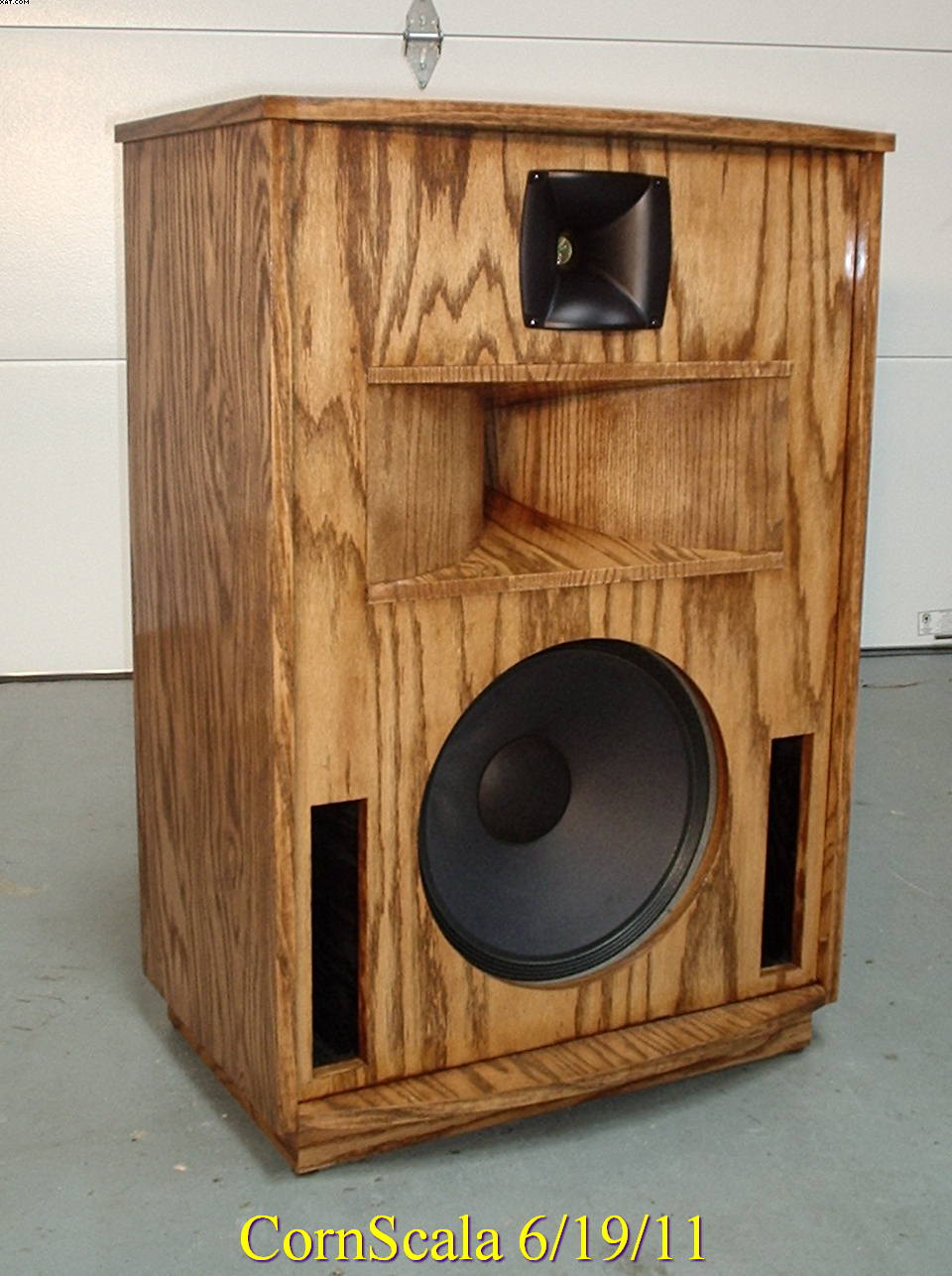

have you ever heard a 1000 USD Cornscala? sound much much better than many commercial speakers out there
above 100db of efficiency and of course 15" woofer:
How do you manage >100dB efficiency with a direct radiating 15" who's T/S specs out at about 96dB?have you ever heard a 1000 USD Cornscala? sound much much better than many commercial speakers out there

The 100dB sensitivity is wishful thinking if intended as a broadband value, but could easily be the efficiency of the MF and HF sections alone, just not when padded down to match the LF driver.
I found the specs on my PC and the value I have for the driver is 95.3dB.
the woofer is Eminence CW1526C with about 100db efficiency. will be more sensitive in a horn structure

I got the specs from Crites and it is 95.3dB and it is not in a horn, it's direct radiating ported enclosure you showed, so NO horn loading of the LF driver in a CORNSCALA. Look on Crites site, the build images for the Cornscala show it is a simple ported box.the woofer is Eminence CW1526C with about 100db efficiency. will be more sensitive in a horn structure
well, Klipsh fans wont be very happy with that
Efficiency differs from SPL sensitivity... CW1526 will do 104-105db@1w/m in a Klipschorn or La Scala folded horn don't forget "Horns are natural amplifiers so they increase efficiency"

Well, duh.Efficiency differs from SPL sensitivity...
Who gives a f... what they'll do in a horn? In a Cornscala they're not in a horn, they're a direct radiatorCW1526 will do 104-105db@1w/m in a Klipschorn or La Scala folded horn don't forget "Horns are natural amplifiers so they increase efficiency"
do they have no horn loading, so it is irrelevant.
