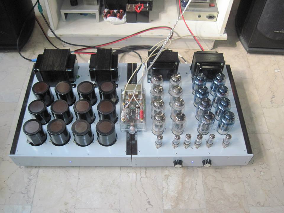

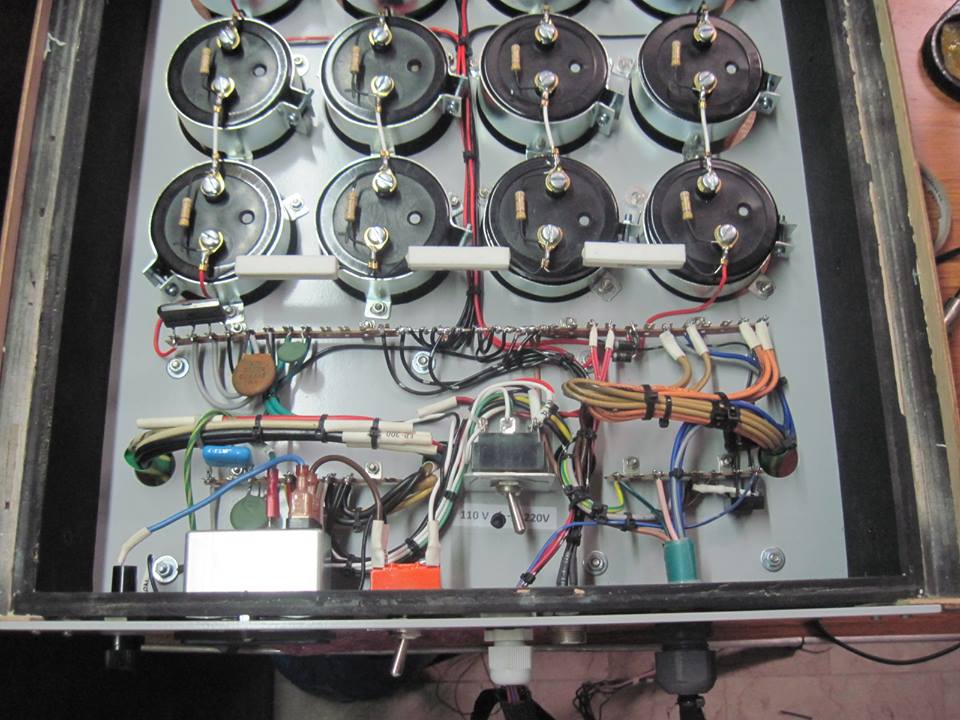

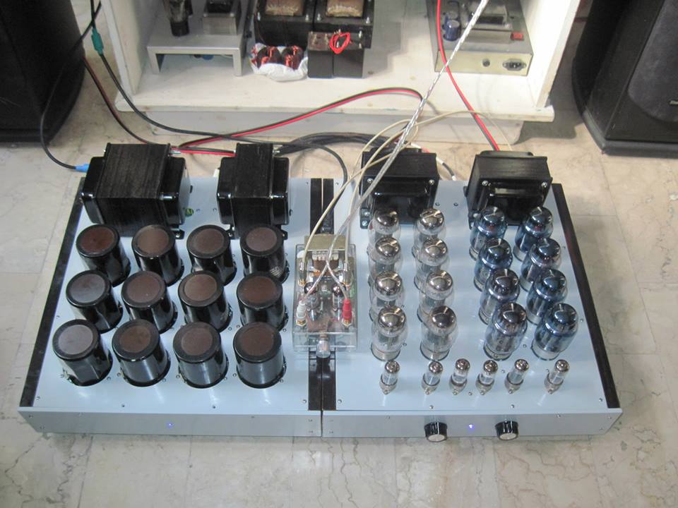

this is how i use SS rectifiers, in the 16kt88 tube amp i built, i used a 1000piv, 16A single in line flatpack bridge rectifier....hey, ss rects are dirt cheap nowadays, why skimp on them...?
