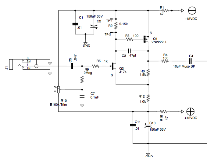

here's a freebe.
I have plots somewhere on diyaudio with different calibrations, domminant 2nd or 3rd or what ever mix. Head-room? Its there.
you can tweak for music instrument or hifi. Must have a real time analyzer though.
You can trim for lowest THD, flat THD, band specific THD and whatever mix of harmonics. (R2 and R10)
I was only able to do this with the P-channel J174. Not sure if its due to jfet N-Ch ion impact physics or what. Other p-ch jfet were not as amenable. Also the circuit is just plain shitty as single supply.
So there you go.
