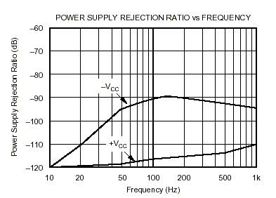

Well, some DAC's (like the TDA1543 with 50db) have not got much PSRR and also share the PSU pin between digital and analog supplies. They are obvioulsy much more critical to PSU noise. Others (like the PCM1074 with > 90db PSRR on all supply lines) manage very high supply noise rejection.
As always, horses for course. The same reg on the TDA1543 will result in 40db more noise in the output than for the PCM1704.
That will need a lot of noise if you use standard Op-Amp's.

"Well, some DAC's (like the TDA1543 with 50db) have not got much PSRR and also share the PSU pin between digital and analog supplies. They are obvioulsy much more critical to PSU noise. Others (like the PCM1074 with > 90db PSRR on all supply lines) manage very high supply noise rejection."
Gee...... what happen to all the data above 1KHz I wonder.
