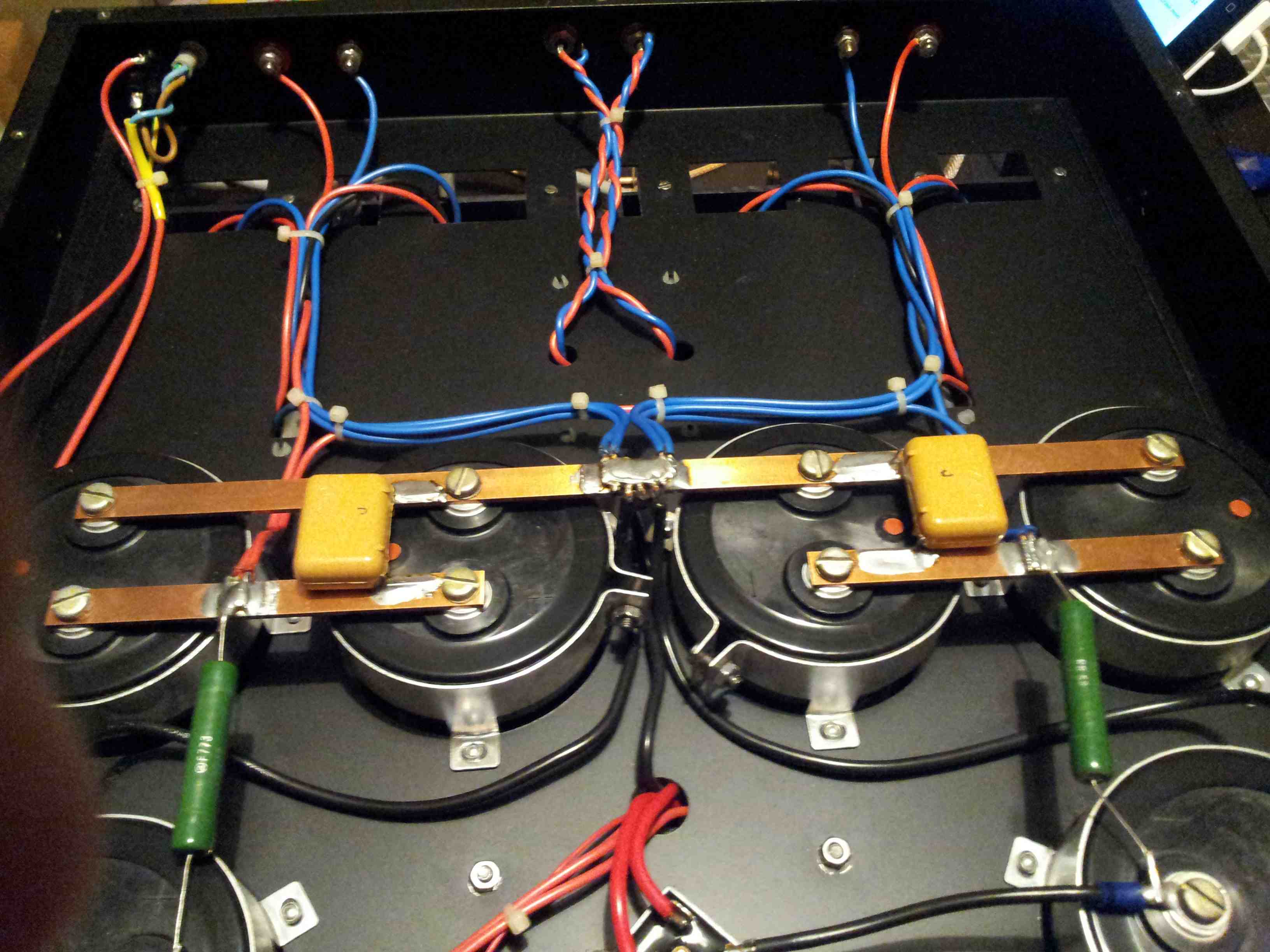

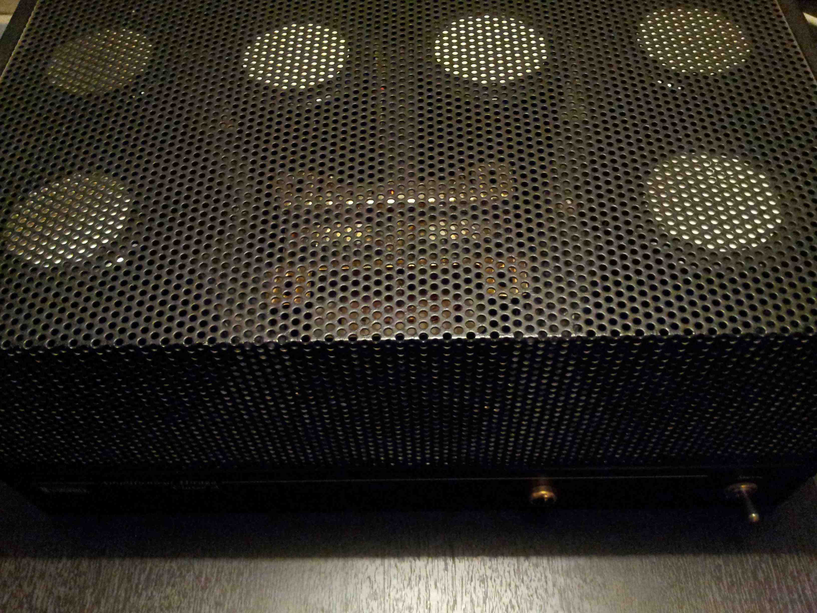

Photos of internal wiring in my class A 20 watt amplifier
made by Mr Jean Hiraga from L'Audiophile

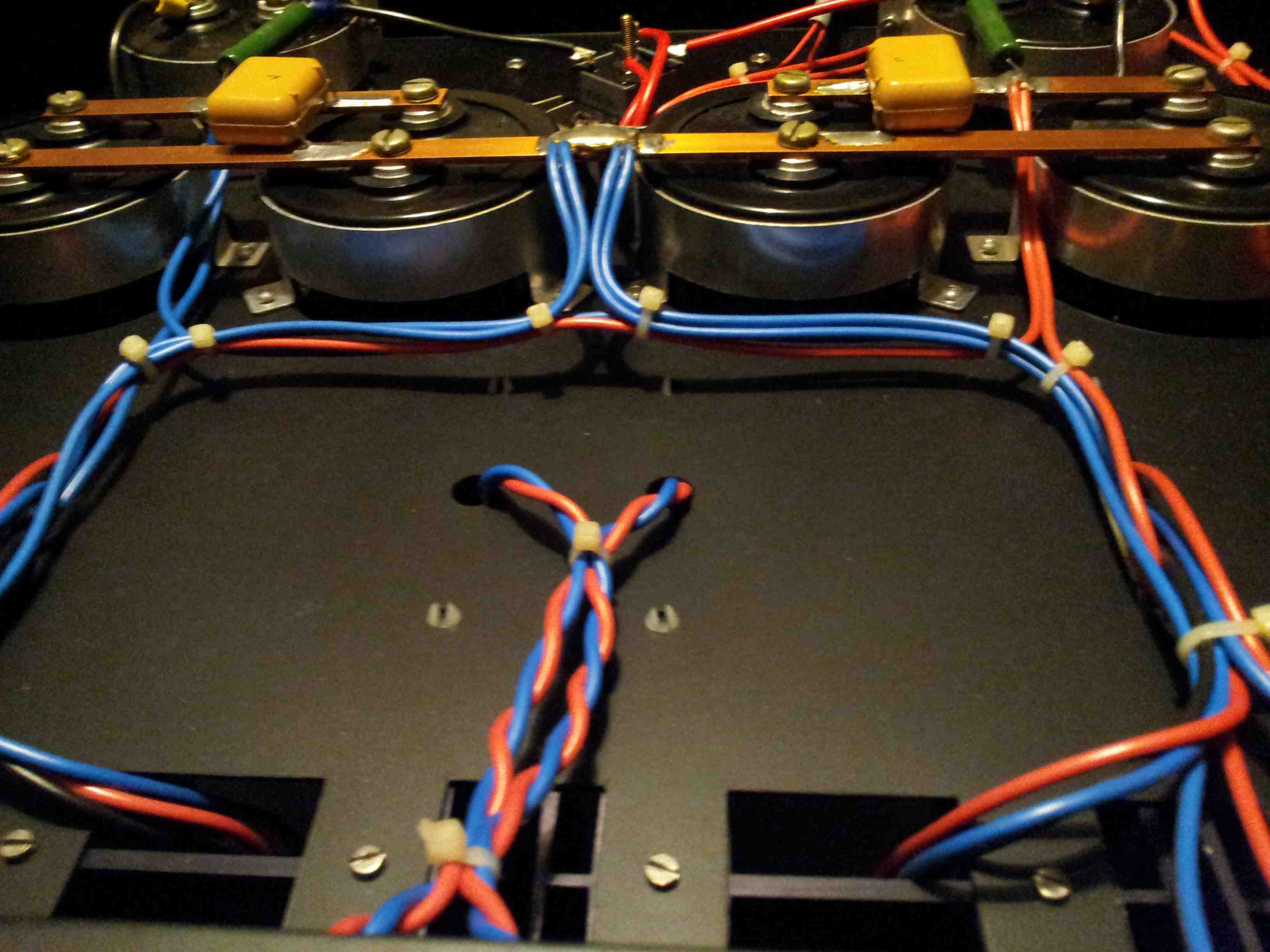

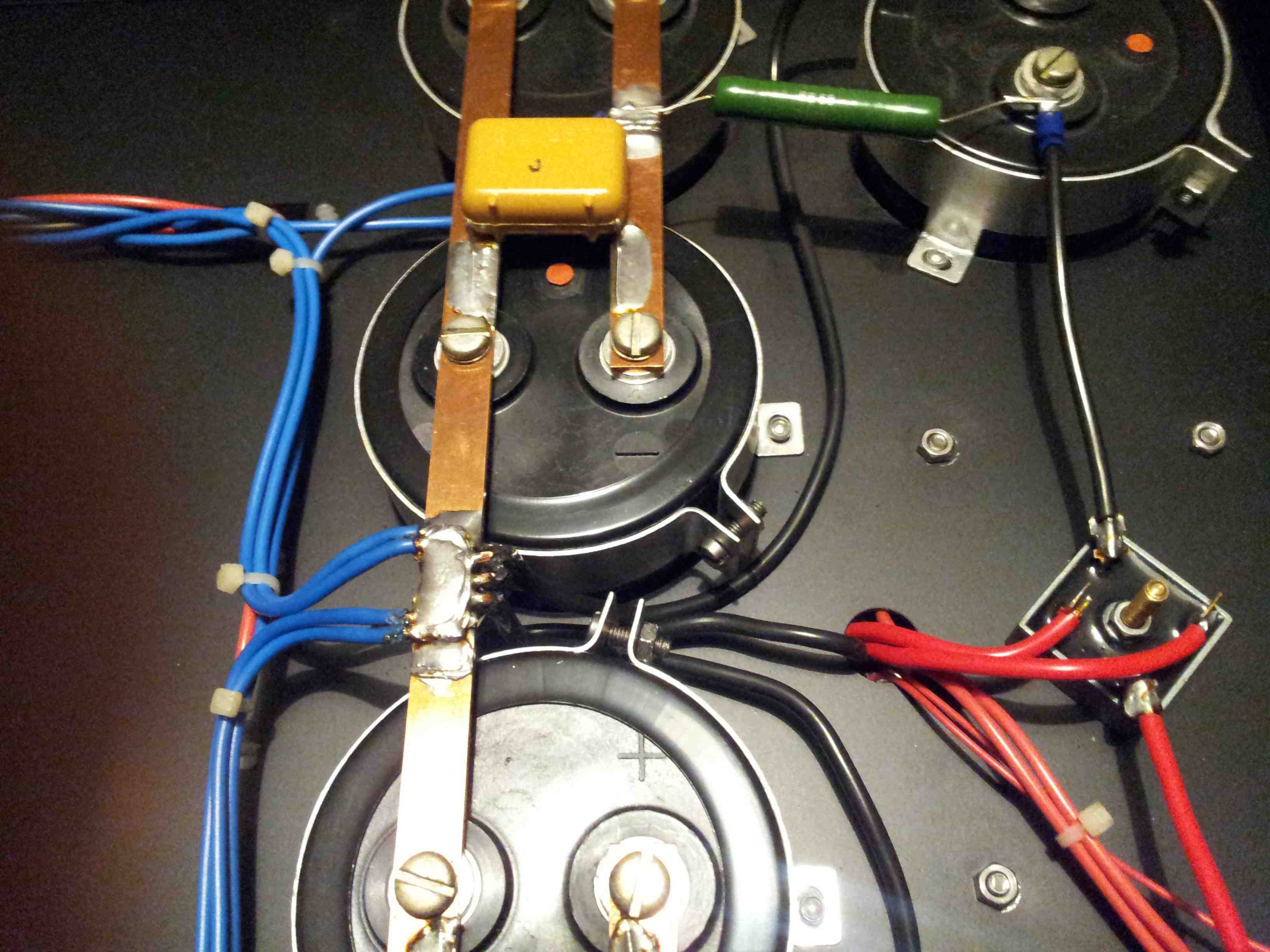

This evening i opened my amplifier.Its huge passive psu i can transpose in F4 , F5 or AlephJ look like a good example.

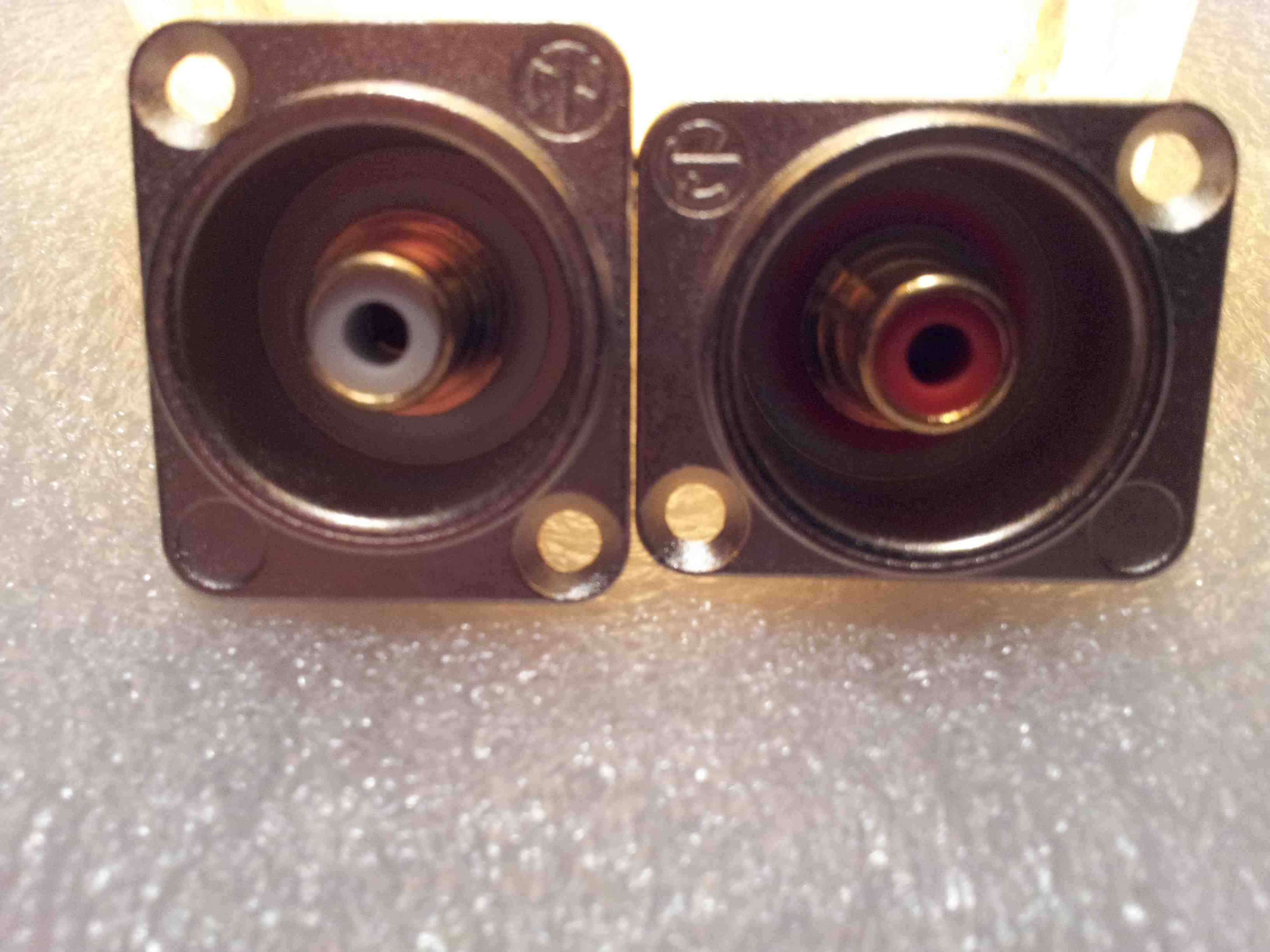

Maybe not for audio part ???Wire is very ordinary one why connected high quality just after on rca's modulation input
For all audio wiring in Pass diy i search constant quality in all signal path...way to preserve delicate musical signal;)

I realize from your posting comments you did not build this particular amp, but for the ones you do build--PLEASE consider the use of rubber grommets, wherever you have wires passing through a metal plate (chassis, apron, panel, etc, etc). This is certainly a VERY good practice for high current power supply and mains circuits...!
The a low probability you'd chaff a lead's insulation badly, but rubber grommets are cheap insurance if you did.......
Just a good engineering/fabricating practice....... trust me.....!!

For your PSU and for leads from the PSU to your amp boards, use the largest (smallest gauge #) that can be threaded into any of the PCB pad holes. I typically try to use #16 stranded copper, or #14 or #12 if the boards can accept that size. (In fact, I've been know to redrill commercial PCB holes to open up the pads to accept the larger wire--and to run additional silver solder on the PSU copper traces, to help reduce resistance via increased cross-sectional area.)

This amplifier be build by old 1985 Paris team from
revue L'Audiophile concept of Mr Jean Hiraga.
Mr Nelson Pass have made Némesis one interpretation from this man with new Sit transistors recently

Safety in all construction , avoid source of danger i write this in near future i protect this wires with rubber grommets:key:
