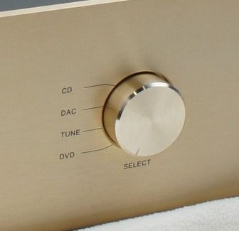

Hello...
An input selector is an unfortunate necessity in my Pre/LS project.
Which one would do the least harm (degradation)?
It needs to be rotary style, because I'm committed already in certain design aspects (case/etc).
A source for it would be nice too...
TIA for your thoughts!!!
Greg

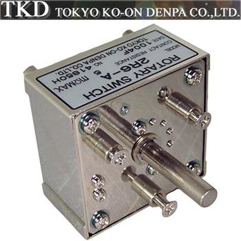

Top quality is GRAYHILL ...... but expansive ...
Hmm... could you narrow the Grayhill down a bit?
Thnx!

Might even be able to mount in in the rear near the input connectors on a shaft.
That's the way to go.
Tromp has my vote.
Signal relays are reputed to be very good at not degrading the signal.
A very cheap rotary switch could activate your signal relays.
The nice thing about these small signal relays is that they can be mounted almost on the input sockets and feed direct to the output sockets with virtually no wiring. Just a few short PCB traces.
