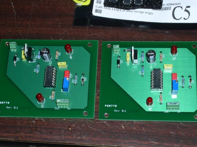

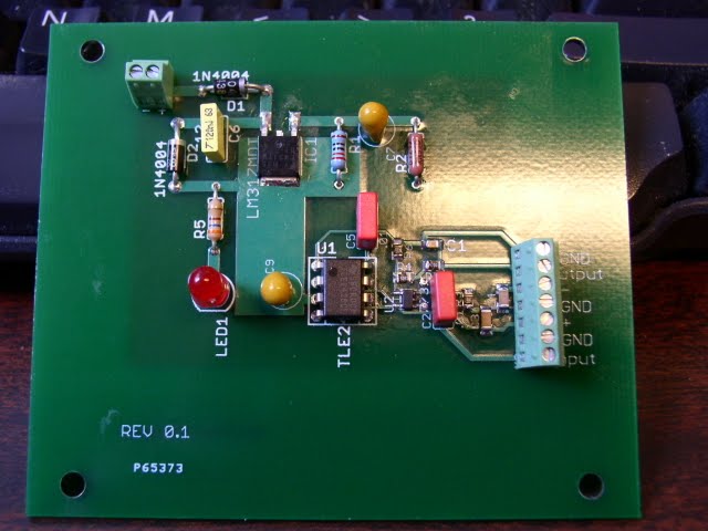

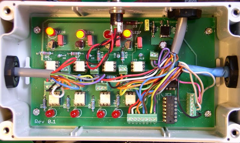

I design 1 to 6 small PCBs a year using the $125 eduction version of Eagle. Full features but limited to 160x100mm boards. For the price it is a good value.
Good:
Schematic capture is good. There is a fairly good component library and adding new components isn't hard. Manual layout is easy. The design rule checks work.

Eagle's Autorouter is nearly useless. I wouldn't pay extra for it.
No SPICE either. You have to design outside of Eagle.
Eagle has a freeware version to download and try. I also tried a couple of free programs but none of them were as good as Eagle.
A few of my boards -- Eagle is ideal for simple projects like these:
