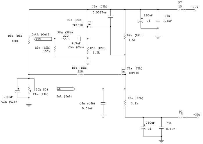

I used that DAC to drive the sources of some 2sK170 and J74 into OP275 for final I to V and filtering. I don't have a copy of the circuit anymore but I used metal film resistors and garden variety NPO/COG caps and it sounded impressive even on the breadboard.

Also the unbalanced I/U section of Pass' D1 could be of interest (definitely better than OPA2604 as I note by a listening test on a DAC with PCM1702).
https://www.diyaudio.com/forums/pass-labs/30208-d1-stage-finished.html#post616248
