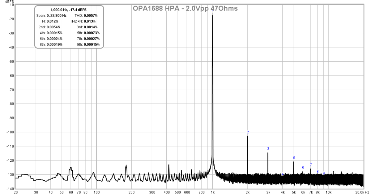

This could be part of the reason why the OPA1688 sounds so good. The FFT shows dominant H2 and monotonically decreasing higher orders. This is unusual for an opamp, which normally are H3 third order dominant due to use of typical LTP input stages. This is 2vpp into 47ohms:
attachment.php

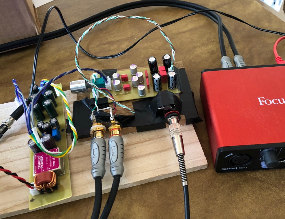

This is my current listening rig while the basement audio lab is undergoing repairs due to flooding. The dual OPA1688 buffer amp shown above plus the PSU from this project: a 310mA +/-18v DC-DC plus TPS7Axxxx LDO regulators and MOSFET cap Mx plus CRCRC filter is an awesome combination. Powered by a 1amp 12v Class 2 wall wart transformer, it is absolutely silent no hiss or hum. With OB-1 headphones and Focusrite as DAC, I can't play it past 1/2 volume before too loud. 150mA of drive at +/-18v is a lot of headroom for most headphones.
attachment.php
This is the PSU - hand etched prototype:
687498d1529328219-aksa-lender-mos-hybrid-aleph-alpha-amplifier-0b93a621-ce0e-4a30-b42f-42966de1c0c8-jpeg
687497d1529328219-aksa-lender-mos-hybrid-aleph-alpha-amplifier-4b1cf2c9-720b-42c0-86fc-57edf59fed33-jpeg
