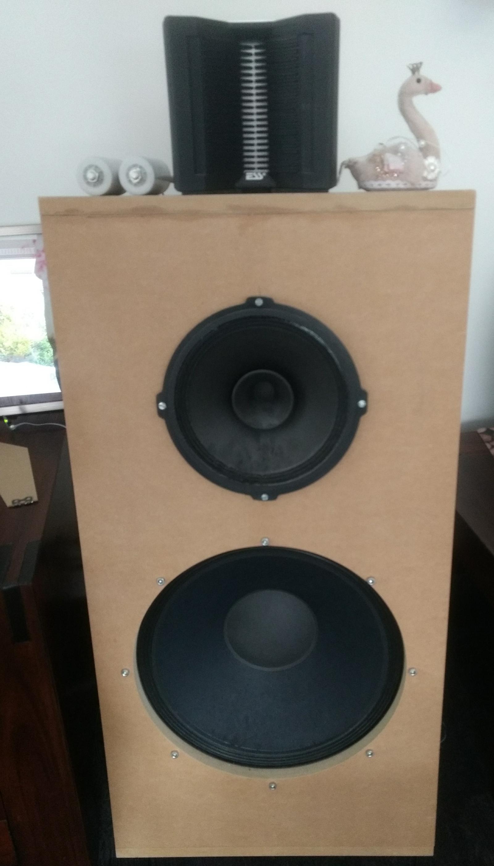

This thread was a very nice read, much useful information. I am looking for a mid driver for 15" PAP+Heil AMT and open baffle, but the candidate list probably is similar as for TPL150. I have already mounted a Supravox 215 Bicone, so I will start trying that out. But I presume there will be better candidates, e.g. for 200-2000 Hz.

Ah, forgot to mention that. I plan to use a Fusion 253 plate amp, so actively driven and EQ is possible. Currently I cross the 15" at just under 1k with AMT, which is working better than I expected, although the distance between the drivers vertically is too high.

Honestly, I do not care about high SPL so much. 99% of the time I listen to modest volumes (background music or avoiding to wake my family up...). I have an L baffle design, for details see my webpage. My 15" is barely moving even at somewhat higher levels so I am fine with one in my ~24m2 room. A single Purifi will work for mid I'd think, but probably would fall short while crossing at 100-200 Hz.
