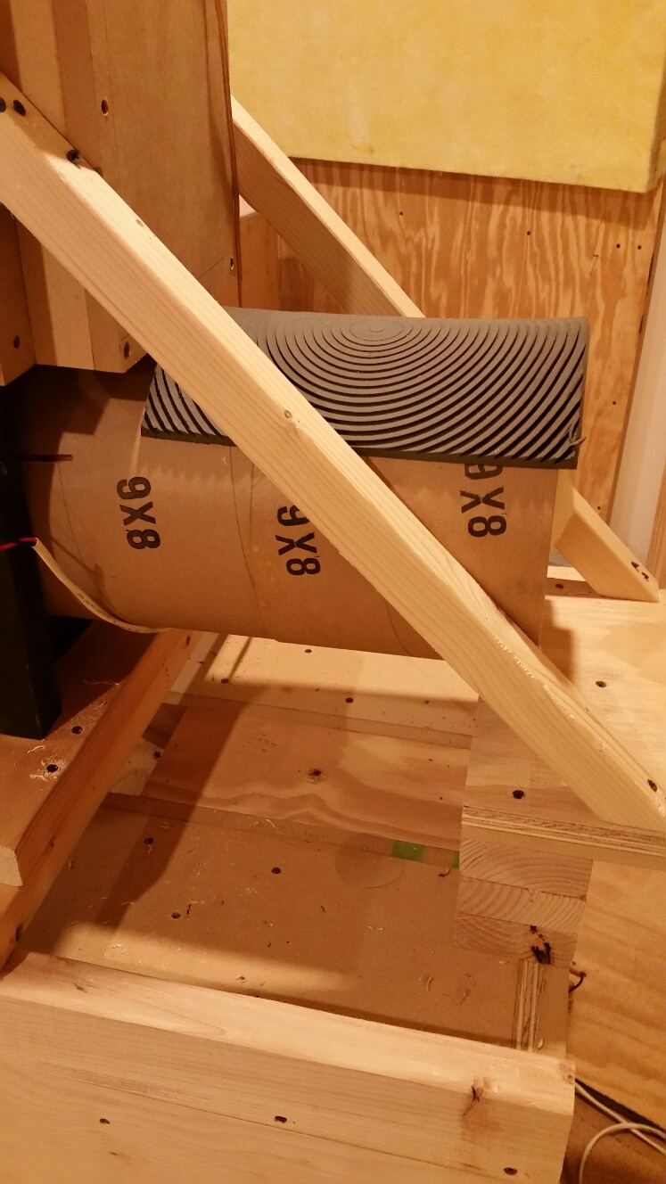

Are you stuffing the pipe exit with drinking straws? (..deflex pad looks a little strange there.)
Pipe damping (to keep it from vibrating) is usually best with a pipe surrounding the chamber-pipe filled with silicone caulk, really depends on the thickness of the pipe though and if the exit is kept from serious (high amplitude) resonance (as with the drinking straws).
No straws. The inner circumference is lined with fiberglass, and the open space (tunnel) is filled loosely with daycron. The deflex pads are just placed there, because I had them in my hand and figured damping 1/2 of the upper/outer portion of the cylinder couldn't hurt.
You have arrived at a similar tactic as my own,

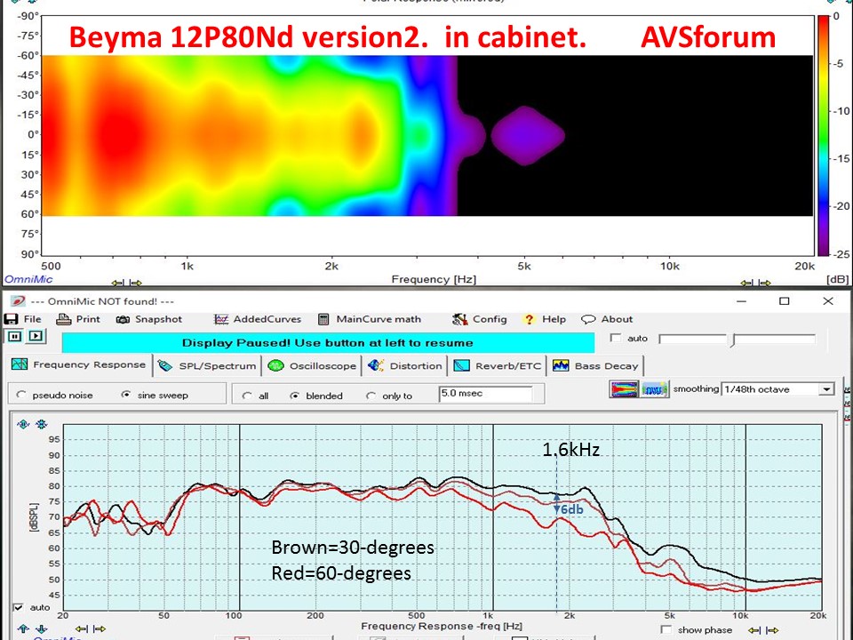

It would be SWELL if Beyma built a larger horn for the TPL150 which would sound great down to 1200Hz with a 80-90 degree horizontal coverage angle. A TD12M or 12P80Nd have very few SPL wiggles below 1300Hz.actually I have not tried it ever. a 12" is not a good choice to cross to a driver like TPL-150H. beaming is a problem
The TPL150H has coverage angles of 80º in the horizontal plane and 30º in the vertical plane. A midbass where the polar response approaches 80º at the selected crossover frequency would produce the smoothest controlled directivity polar response throughout the crossover range. "some beaming required"
Polar measurements of a 10" with a curvelinear cone like the JBL 2123H illustrate the crossover potential around 1600-1800Hz for both a smooth frequency response free from major cone SPL wiggles, and a matching polar response(beam width) around 80º .
Measurements for the Beyma 12P80Nd_v2 from the AVSforum show -6db SPL around +/- 40 degree polar response ... a close match to the TPL-150H.

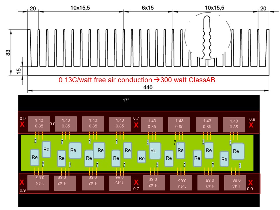

I wish I could afford one of these but will probably have to build my own.
Form should follow Function.
BIG, DANGEROUS looking heatsinks are the COOLEST!.
