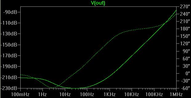

Terry Demol said:
ikoflexer,
What ESR and ESL values are you using for the OP capacitor
model on these sims?
T
Used .5 ohms ESR for all caps in the simulation, and no ESL. What value would you recommend I use for ESL? Thanks.
Edit: BTW, here's another result using the lm4562.

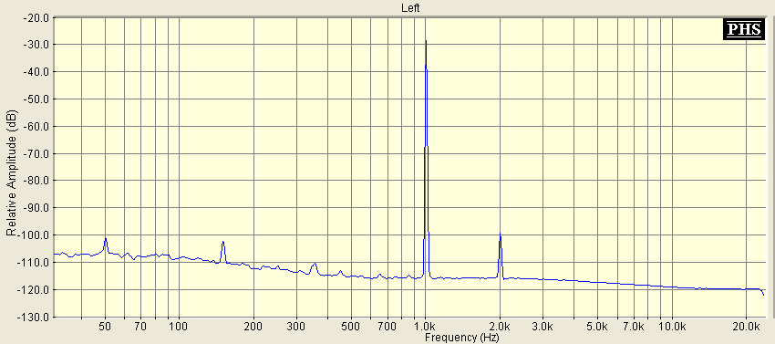

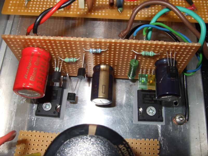

Jan, I replaced the R6 1k load with your recommended Idss Njfet CCS load. I does not oscillate, it worked OK for a series of on/off cycles loaded by 2 channels phono stage, 40mA total for about an hour. Here is a picture, you can see a 7.8mA Idss 2SK170BL in place of R6. (The one with the 2 grouped legs). Thank you!
I am about to listen to it carefully now and report in a while. ;) Silly me or not, if I can't tell a positive difference by ear, I don't adopt stuff. I maintain that the only goal in making audio devices is better listening in the way or method anybody thinks is suitable no matter how flawed. Yes, low Rds (on) hefty Mosfets sound more substantial to me in the shunt, I took time to try out some alternatives. I know I must amuse real engineers, you gave me a tip, I gotta pay back with some comedy at least!:clown:
I also took an FFT of the phono + modded shunt. Not much better noise floor under 1kHz, a bit smoother there, 3-5dB lowering of my hum spikes but better noise floor in the highs. The FFT is presented in 1/24 octave, not exponential.

The FFT. This comes from my 44dB phono version, driven with 1mV 1kHz. Both channels are fed by the modded shunt reg above. 1/24 octave scaling for X axis, 0dbV = 1V RMS for Y axis. Emu Tracker Pre at 48kHz sampling rate, 24 bit.

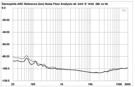

Yes I have a mains transformer and 230VAC cable at about 15cm away from the Riaa and about 10cm away from the shunt, in the same box. So I get some mains 50Hz hum and its harmonics summing etc. But I have measured very expensive commercial phono stages in huge boxes and they give the same stuff plus 100Hz at around -80dB, so I think I must be content. My box is 26cm wide.
Audio Research Reference Phono model's noise floor (lowest gain, shorted inputs, looks like exponential X axis). Stereophile Year 2000 model measured.

OK I have listened to the added CCS mod carefully with known material:
The shunt + phono is a little softer in the highs and a little broader in the mids now. It gives a slightly better ''together'' feel including the bass. It may have lost some U shape depth of imaging, I have to listen more to confirm that. Perceptible differences but not high contrast ones, rather positive, to conclude for now. I will wait to hear the opinion of a couple of friends that will do the mod and listen independently in their systems. If it proves positive overall, I will recommend the mod to the gang that made my phono and shunt in the respective thread.
I would like to thank again Jan and syn08 for the tip, analysis and cautions. Also for putting up humorously with my subjective bubble talks. Also jwb for making it and confirming its low noise (top priority when using it for phono), Ikoflexer for his rapid simulations and support, as well as all the good people sharing their ideas and knowledge in this thread. Last but not least, analog sa for opening this thread. I don't know for best low noise reg, but what I got is low noise at least and suits my purposes. So I am content. Thanx fellas!:grouphug:
Which issue of Stereophile was that from ? -- the noised is referenced below 5mV? I think they are just measuring amplitude with the inputs shorted.
If you want to measure noise of an amplifier without the benefit of a sharp bandpass filter, measure with a 1K resistor then a 10K resistor, then short the inputs. You should be able to derive the device noise, separated from the ambient under these conditions.
