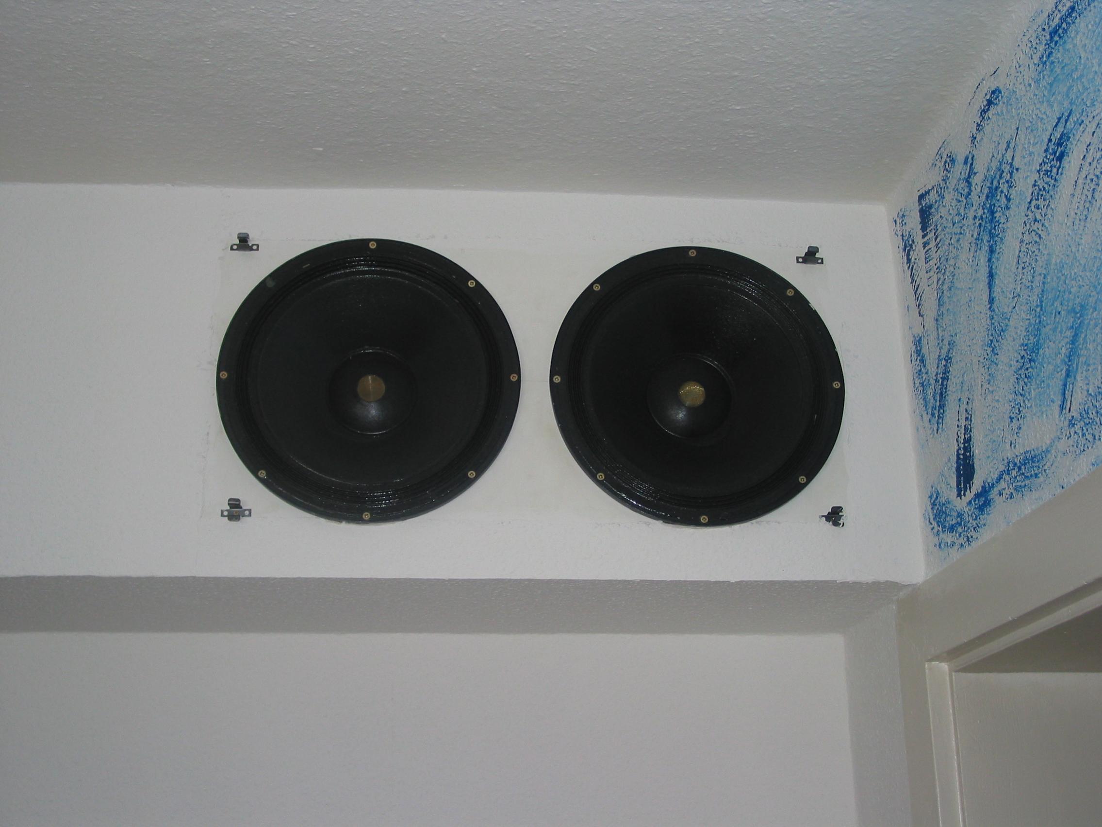

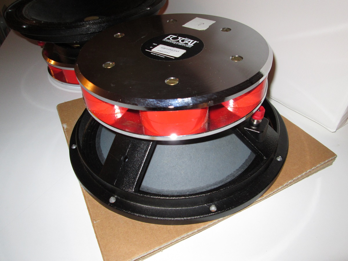

1) Audiom 12AX
Strassacker: Lautsprecher - Boxen - Selbstbau
(see also attachements from one of my projects)

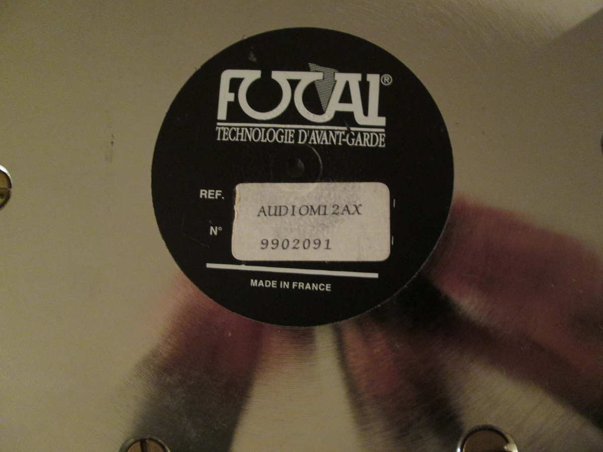

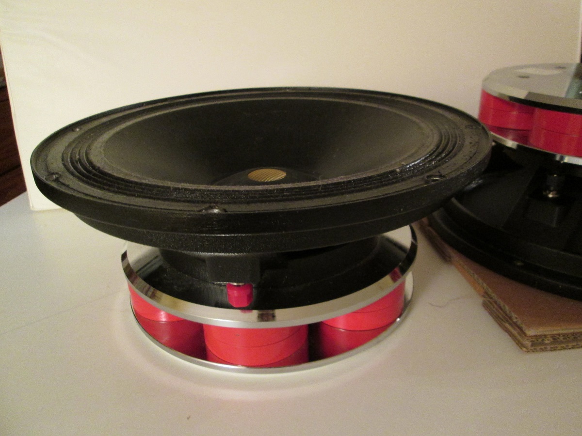

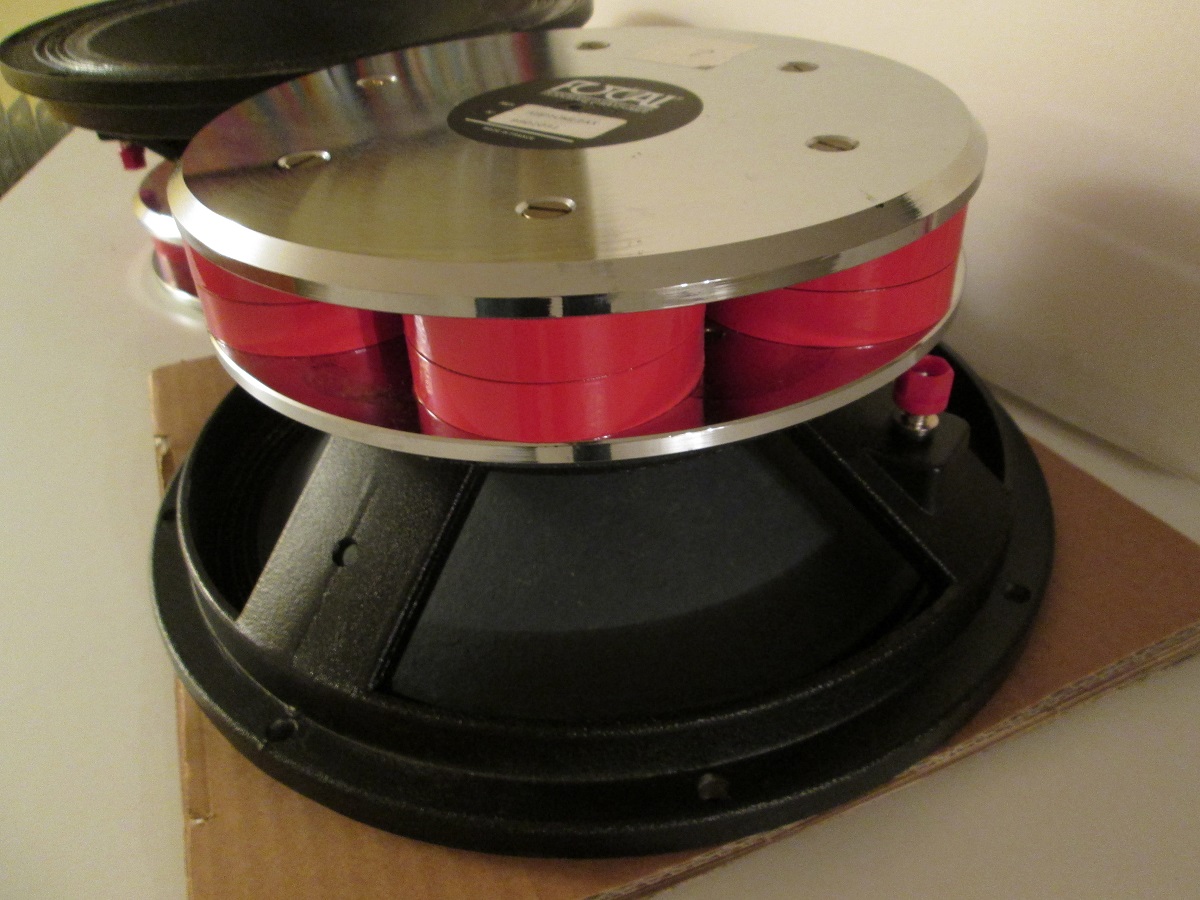

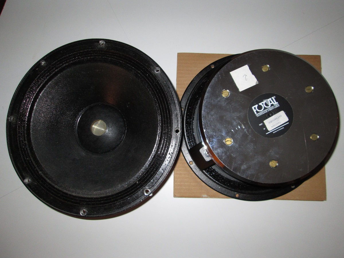

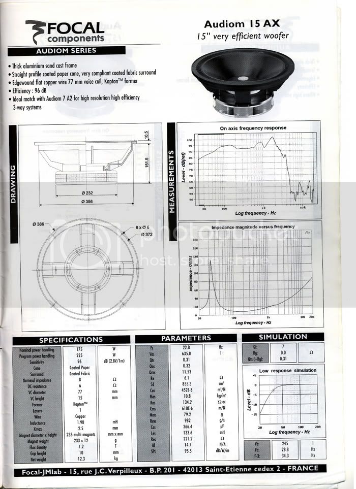

Focal Audiom 12ax Images and Data Sheet
here are some images and genuine data sheet of Focal's Audiom 12AX
Qms is nearly 10, but the associated diagram of impedance is missing (frequency response was printed twice).
Is there a correction resp. supplement by Focal (last image from 15ax shows the correct diagram in this case) ?
Thank you for upload.
