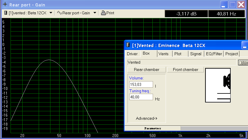

Here a budget 1"of bmspro 800Hz-30000Hz 113dB/1Wmtr.Overview
BMS 4524 - 1" High Frequency Compression Driver 8 Ohm - BMS4524 - STEREO LAB
BMS advise often XO near cutoff with their drivers this means 800Hz with this one, they are robust. With a 3-10W tube amp there will be no damage. Probably you need less than 1W because it does already 113dB at 1W! Before your woofer does 113dB/1wmtr there is serious power or efficiency needed.

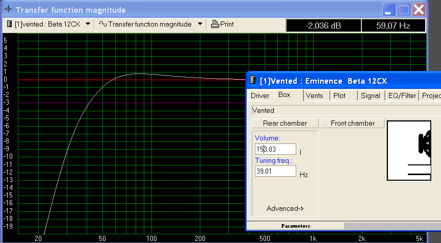

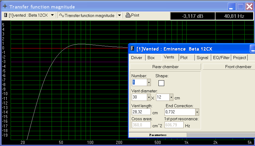

You could save money on a wave guide and bold it on this low price coaxial(you need to buy the 3/8 threat adapter).http://www.eminence.com/pdf/Beta_12CX.pdf
And buy a second 12"to increase efficiency of the low frequency.http://www.eminence.com/pdf/Delta_12LFA.pdf
98-99dB/1Wmtr shout be possible.:)
