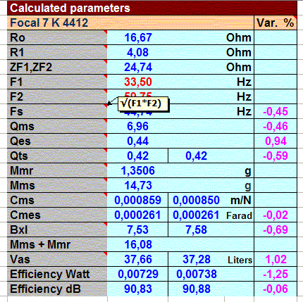

formulas
Hi Tony,
you can see the formulas by placing the mouse cursor on the little red triangle on each parameter cell. The spreadsheet is protected so that only the needed parameters can be written, protecting the calculations from being erased.:bawling:
Claudio

Hi Ciclotron,
looks like mine XLS helped you, isn't it?
Check your EFF. CONE DIAMETER, it shoul be mm. not cm.
Chris,
BL=[(2*Pi*Fs*Re*Mms)/Qes]^0.5 is the same of BL=2,51*�ã(Fs*Re*Mms/Qes) that is the one I used.
Now your BL value differs of 30% from what? The manufacturer one?
SW doesn't calculate BxL, so in my spreadsheet I calculate its value using the parameters founded with SW, and compare it with the manufacturer value.
About Voice coil inductance (Le), Voice coil Series (L1), Voice coil Series (R1), Speaker Workshop calculate them , you don't need to input them.
Regards
Claudio
