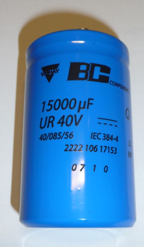

Any comparisons of these with, say, BC Components, SlitFoils or Mundorfs?
