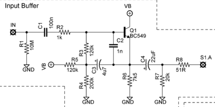

I'd also found this schematic, but it's different
Yup. Not sure either are what Mr Cornish had done (although the BC549 is historically likely). The schematic won't get the Zin >1M that Mr Cornish insists on. I've not had a chance to reverse engineer the vero board version. I do suspect the original has been through a few variations over the decades

The schematic I found online (attached) is what is called an "emitter follower". This is a type of one-transistor circuit that passes a signal through unchanged - it doesn't make it bigger, it doesn't make it smaller. (Technically, it has a voltage gain that is just a hair less than 1.0 .)
I don't know if this is really the correct circuit for a Cornish Booster, but if it is, then it doesn't actually boost the signal at all. But it does "buffer" it, which means the guitar signal won't become weaker - loaded down - when you feed it into a pedal with a somewhat low input impedance, like a Big Muff, for instance.
In the same way, the guitar won't be loaded down by a long cable's capacitance, so you won't lose treble even with a fairly long cable.
Compared to the germanium transistors that came before, that BC549 transistor was a marvel when it was first introduced on the market - quiet, fast, reliable, very high current gain.

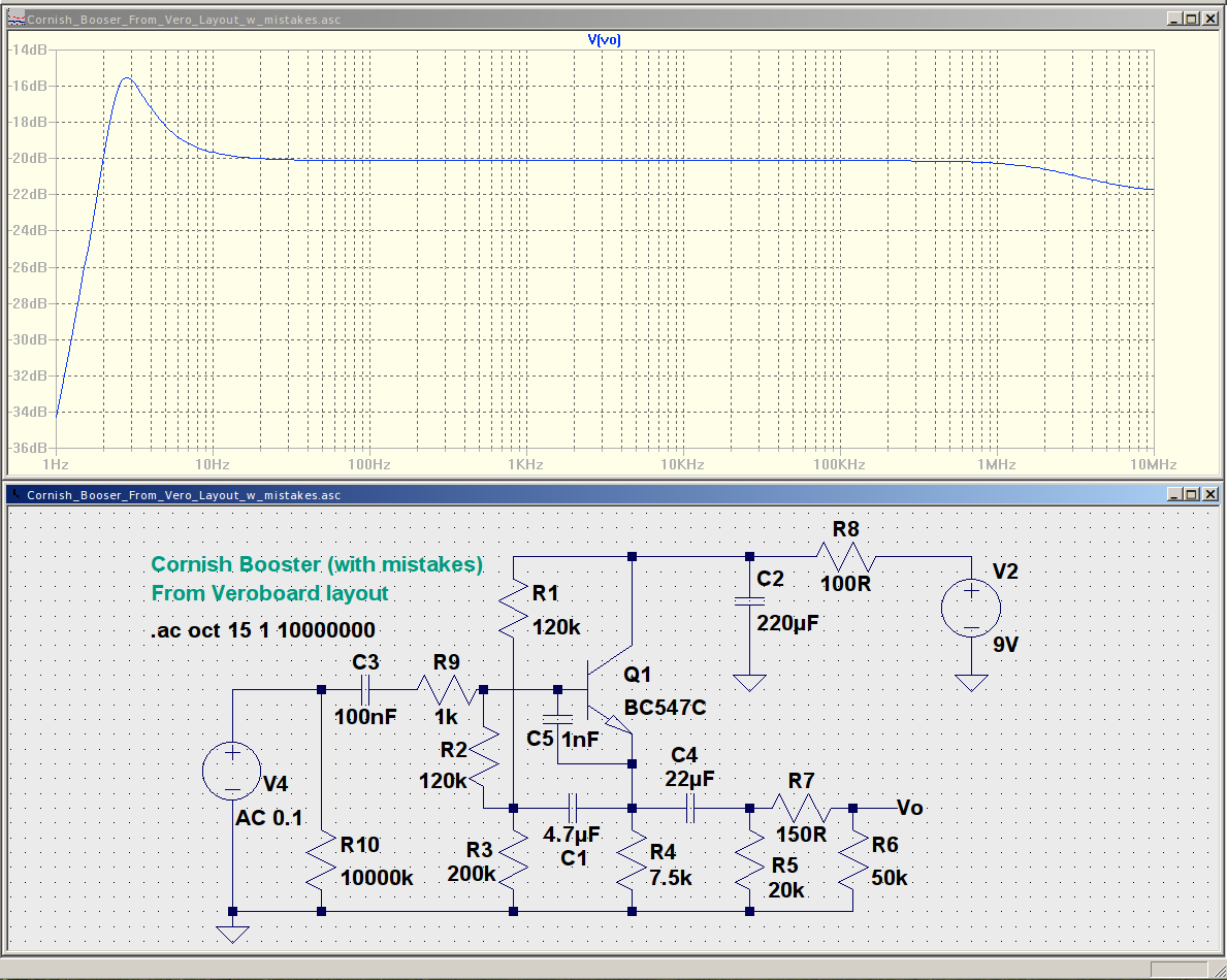

Since there is continued interest in this circuit, I took a few minutes to turn the Veroboard layout back into a schematic, and then run it through LTSpice to see what, if any, mystical magical musical mojo-matic properties the circuit might have. :D
The transistor I used in the simulation is from the same family, and has very similar characteristics, to the specified one.
...additional power filtering.
Yes, via a 100 ohm resistor (R8 in my attached LTSpice schematic), and 220 uF capacitor (C2).
A good idea, and also entirely typical. Every guitar pedal has something similar to make the power supply rails behave, and ensure low power supply impedance at high frequencies.
..with a whole bunch of clever filtering going on
Sadly, I don't see any clever filtering. There is a 1nF cap across the transistors base and emitter, which is a poor place to put it, because there are nearly equal signal voltages at both ends of the cap.
That means the Miller Effect, in this case, makes the capacitor behave much smaller than it really is. As a result, that capacitor is essentially useless at any frequency we care about.
I ran a quick frequency response simulation in LTSpice, and sure enough, the bandwidth goes out beyond 10 MHz. You could (and very likely, will) pick up shortwave radio with this thing!
To put it plainly: building an audio circuit with a 10 MHz bandwidth is either incompetent, or irresponsible. Especially when it's a guitar circuit, which will have a length of cable and magnetic pickups connected to the input. That stuff dangling off the input is likely to feed unwanted RF signals into it, so the proper thing to do is ensure that any guitar electronics rejects frequencies that are substantially higher than, say, 15 kHz.
As it turns out, there are other problems with the circuit. Bootstrapping via a feedback capacitor looks very clever, but has a nasty side-effect: it almost always creates a huge hump in the frequency response at very low frequencies. This is caused by the combination of positive feedback, and increasing phase shifts at low frequencies in the input and bootstrap capacitors.
In this case, LTSpice confirms that we have a 4 dB peak at about 3 Hz (!) Thump on the guitar body or on the low "E" string and this booster circuit might experience blocking distortion as a result of large subsonic signal swings at 3 Hz.
A guitar circuit has no business having any sort of response down to 3 Hz; all that does is open a window for excessive low-frequency (flicker) noise, low frequency instability, et cetera. A six-string guitar in standard tuning only goes down to 83 Hz, so there is no logical reason for a guitar buffer to go lower than, say, 50 Hz.
Lastly, there is at least one outright mistake in the circuit, which is unlikely to have come from Mr. Cornish, but from someone who failed to notice R5's function. So he/she added the utterly useless 50k resistor (R6). It does nothing that is not already done by R5.
At this point, having traced out the schematic, and simulated its workings, I can say with confidence that this particular booster circuit has absolutely nothing special or magical about it. It's just an entirely typical BJT buffer, with a few sloppy design mistakes thrown in. The mistakes are not show-stoppers, so the circuit will certainly work.
I'm attaching the LTSpice sim file (.asc) as well as the screenshot. If anyone wants to, feel free to run the simulation yourself, and/or tinker with the schematic to see if you can fix the poor frequency response characteristics.

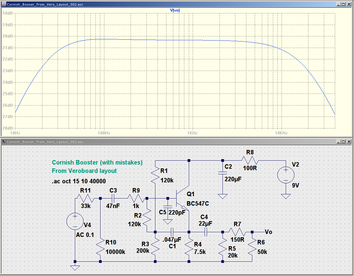

To demonstrate that point, I tweaked the cap value down - a lot - and you can see the results in the attached screenshot. No more subsonic peak! Now the bootstrapping is well-behaved.
I also tweaked the input coupling capacitor to create a more appropriate bandwidth for guitar use. And I removed the useless 1 nF cap, and added in a smaller cap in a better location to roll off the frequency response above 10 - 15 kHz.
I added the 33k between the input voltage source and the buffer circuit to simulate the source impedance of the guitar - unfortunately, this is very variable, depending on where the guitar volume pot is set. And it does affect where the HF rolloff occurs.
