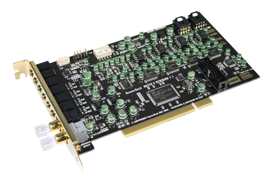

FastEddy said:Re: lynx 2B , X-Meridian, et al sound cards.
I am very sure these all sound quite nice, unless installed in an inexpensive WinPC computer. Again, "... 4) Because the computer box is a very dirty, noisy electronic environment, the sound "card" should not be a card at all, but an external device, separated by some distance from the computer interior ... unless the "no cost" criteria includes the computer as well. ..."
Now I can't speak to the specifics of the above manufacturers' efforts to clean up PC switching power supplies, but I would bet a great deal of effort is involved. However these PCI plugin cards can not come close to an external DAC device, with or without optical isolation. I have yet to see a plugin sound card that didn't have a serious problem with the PC's noisy, dirty supply and the high frequency processor switching noise and harmonics ... you can easily see the switching noise components on a cheap 'scope and quite often hear it. Even external devices require significant effort to reduce this noise, simple separation distance seldom being enough ...
have you ever tried it? i gave this same argument before i tried it. this blew away any other external dac i have used. try it and amaze yourself. even the $200 M-audio blew away the processor and dac in my rotel 1098 (a $3k processor), and this is one of the best sources ive heard. all we hear about is how noisy and nasty pc's are. well, give it a shot, you might realize its not nearly as bad as you thought it was. ive never heard a noise floor as quiet as with my current system.
i also dont use any hard drives in the system (all flash drives for OS), and music is stored on a server in another room, and there isnt a single fan in the computer. there is still a computer power supply, but it seems to be very quiet (passive, no fans), so maybe there is less noise from that.

4fun: " I have a PC equipped with a cheap PCI Audiphile 2496 and it's dead quiet when it's supposed to ..."
Yes, and I have seen some very good audio I/O from PCI cards as well ... but the simple act of physically placing the digital to analog conversion components away from the PC's interior does make for a world of difference, generally a better than 10 db reduction in the noise floor. Granted there are very good PCI sound cards and very bad external DACs ... and I have no problem with keeping what works for you and ignoring what may work better in the absence of solid proof ...
M-Audio does a very good job of filtering that noise from their plug in cards as do several other manufacturers. But, M-Audio engineers will freely admit that their external devices are better, even when using the same chips and filters.

FastEddy,
External "pro" sound cards will most likely be equipped with internal SMPS (ok, a very small power SMPS but in closer approximately) in order to provide +/- rails and at the same time be sourced from firewire/usb power. There is of course the possibility to use external power but i bet they are single rail supplies (SMPS) feeding the same path as USB/firewire power delivers.
Where else does 48V phantom power come from?
I also think the performance of internal cards have been proved several times here before, if not by all sound card meauserments shown.
I think a very god external DAC would be the best solution, but as mentioned others, that is not self evident apparently.
