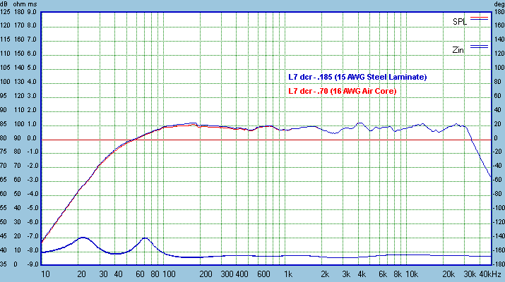

Would you consider this woofer as handling midrange?

Crazyhub......Whatever the coil, that chart doesn't look too bad, but your midrange is gonna sound a bit too forward.......Roland Bio asked about a resistor in mid, which is what I think he's getting at....and I think he's got a good question.......You might also consider a larger series coil in the mid section, especially if you don't want to add too much more resistance to your circuit....Omni
I use a 1.5 ohm R in series with the middriver, that's not my point.roland bios said:Hi,
The brown line? Yes that's midrange. What is your point? Do you use a resistor to match the efficiency?

The blue line is the woofer so do you think this woofer is reproducing enough mid-fr to necessitate an air cored coil? Do you think a SuperQ 3.3mH will introduce a distorsion level that may mess things in the midrange, notably at average level (50 years old and yet clean ears)?
The middriver is an accuton C79, the woofer a C220NT6 and the tweeter a Focal Utopia-be; two months of intensive voicing stage ended up with these SW curves giving me a perfect in room balance. I use a 3-way series// filter, 2nd order electrical on woofer and 1st order highpass on middriver. I tested 3.9mH instead of 3.3mH and it's mainly a matter of // caps value; in fact the C220NT6 is much more able to handle lowmid fr than its brother C220T6 so I hadn't to cut it at lower fr.omni said:Crazyhub......Whatever the coil, that chart doesn't look too bad, but your midrange is gonna sound a bit too forward.......Roland Bio asked about a resistor in mid, which is what I think he's getting at....and I think he's got a good question.......You might also consider a larger series coil in the mid section, especially if you don't want to add too much more resistance to your circuit....Omni
edit: you told about the lowpass coil in series on the middriver! I tested larger values but the tweeter isn't able to corrrectly handle a lower cutoff fr than the present 2.7Khz, 2nd order.
Ah ok, now i understand your question! We are talking about the blue line in the graph. The woofer. I do not think you will have any THD problems when you use an Erse Super Q 3.30 mH. Thd will be well below hearing levels. But since you use the accuton pretty far into the midrange, some other effects may become interesting. Low microphonics for instance. A copper foil inductor will bring out some more details in the bas. Marc Heiligers did some research on coils, that you might find interesting, since his design also uses accuton drivers.

Yes Roland, my woofer plays at the border line between mid and bass ranges. I knew Marc's milestone site and his coils and caps measurements but they seem not to be of great utility for what I'm looking for. I mailed to Tony Gee to get his advice but I guess he will say me "chose the biggest wax or foil you can buy/find", haha.roland bios said:
