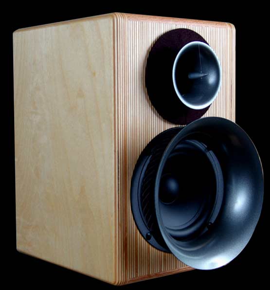

The Kawero Chiara is specifically designed for this (and far more obviously physically):
"RAINER WEBER, KAISER ACOUSTICS
The Chiaras have some very innovative features that contribute significantly to their performance - two of which we can shed a bit more light on.The dip in the presence band is deliberate. We do not design to flat frequency response in that band, rather we design to the FletcherMunson curves of equal loudness perception. This dip only occurs on axis - by 30 degrees off, the response is very smooth (+/- 1dB in that range) and by changing toe-in of the speaker, you can actually ‘set’ the frequency response at the listening seat for individual preference."
I still don't understand how a small recess is going to affect power compression like that in any way.
It's not really power compression at all because it's not "system-wide" - it doesn't lower spl at all axis's. Instead it "hits" just a narrow range of the polar output: specifically directly at the 0 degree axis. In the case of the Magico (and it's shallow depth "inset"), I wouldn't be at all surprised if the drop in pressure is within +/- 7.5 degrees (..and maybe more like +/-4 degrees). Something far more exaggerated like the Chira however probably expands that to over +/- 20 degrees.
Think of it as concentric combing.
It's that concentric nature that allows the diffraction to lower the response within a small area - it "builds" with an increase in pressure by the driver as it all "centers" together.
I believe that room modes do the same to bass freq.s, resulting in dynamically non-linear dips and peaks in pressure.

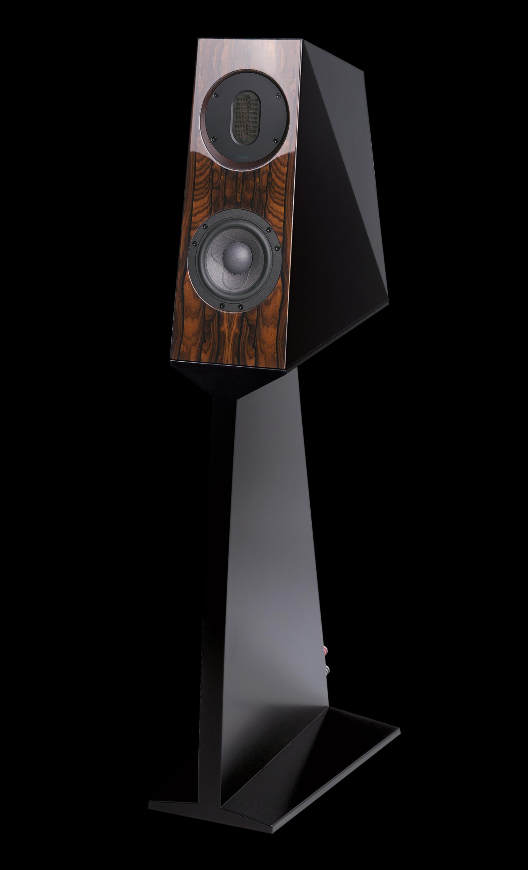

What about this....
Hi to all....
This one is one of the best new speaker in one of the online audio magazines (forgotten which).
should be VERY directional and no reflections from wall or else:eek:
And the tweeter is a AMT. I can find another picture that shows the AMT and how deep it is recessed!
Is this a wanted way of getting good sound - don`t know:confused:
Best
Olav
The tweeter is sourced from Scan Speak, as is the mid-range I believe (..though using Magico's diaphragm), as are the bass drivers. The drivers (not the tweeter) in their more expensive line are Morel - and actually are inferior. Only the mid-range is really "custom".
In the S series, the midrange motors are of the Coppersleeve Morel lineup, combined with Magico's 'nano-tube' cones.
There's no mistaking the midrange's frame in my eyes, as I have a set of Morel 6" CAW634, and the S3 I've seen in person. The S3 also had 22W/8857T style woofers with carbon fiber dustcaps- YUM!
I don't know why you are saying the Morel motor types would be inferior to the SS motors, but both have measured in their respective namesake models to have ultra low HD and be SOTA drive units.
