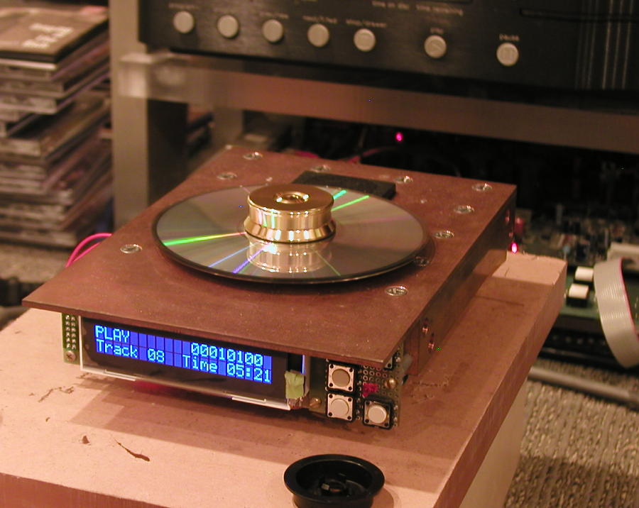

I did some listening tests today on my CD-Pro2 with magnetic clamp and with Sony sourced brass clamp. The latter certainly sounds better to the point that I will not go back to magnetic one: there is more air and dimentionality, while with magnetic clamp the sound is rather "gray" and less involving.

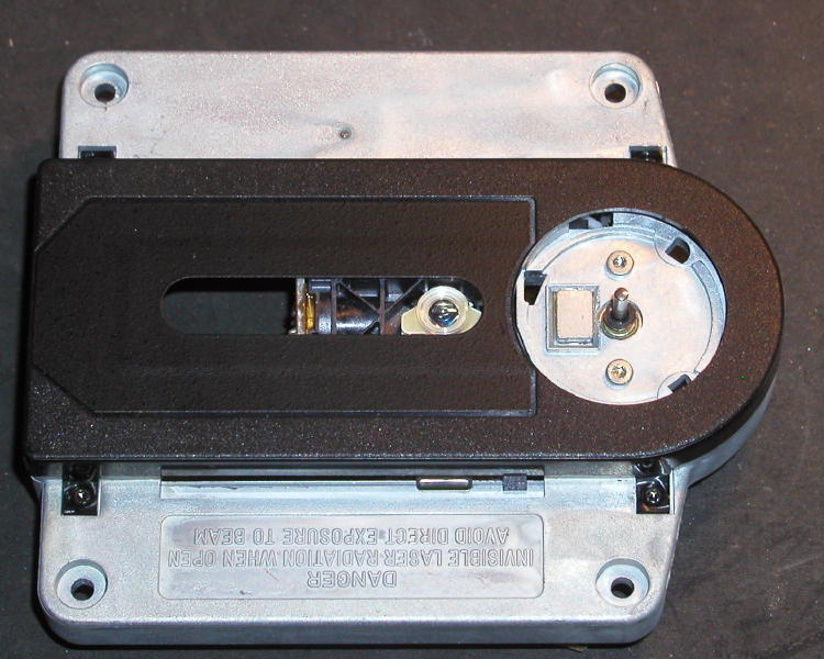

The way the magnetic clamp works on CD Pro is not optimal either. The magnet does not "stick" to the turntable, but to the steel plate attached to the die cast frame. That creates unevenly distributed forces that affect motor bearings and the way the motor works; the motor mechanism is under costant stress, possibly bigger than from a heavier non magnetic clamp.

What is the table made from? Are you sure it isn't metal, or has a metal ring underneath?
Every transport I have ever seen with a magnetic clamp has a metal turntable, or a metal ring under a plastic table if they are super cheap. A metal table ensures that the CD runs true.
-Chris
CD-Pro table is made from aluminum. I came across the magnet thing accidently, when I was swapping mechanisms in ML31.5 and the tables needed to be replaced due to different openings in the clamps.
http://www.diyaudio.com/forums/showthread.php?postid=751296#post751296
I also tried to compare the rotating mass of a disc with the Sony clamp and with the magnetic clamp (by turning CD with my fingers). The feeling is basically the same and it's hard to detect any substantial differences.

Well, months ago I did the above mentioned comparison and I decided not to listen to it until it used a proper non magnetic clamp. Adapting a portable CD's mechanism was not possible without risk of dammaging the center hub so I planned to build my own. Because of the lack of resources and competent technicians here, I ended with a primitive yet trusty, Al based, lightweight mechanism whose photo I could show if ever my little daughter lends me her camera :D It was made on a big industrial machine tool so it is not perfect. Maybe you who have better tools can make a better mechanism...and probably sell? :angel:
