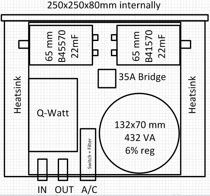

Hi Andrew - thanks. Very useful. How should I work out the A/C snubbers around the transformer? Is there a basic set of figures for a 400VA / 40mF centre-tap arrangement? I'll have access to lab at work so I can measure inductance and picofarad capacitances.
Patrice - wow. Just wow.
My proposed layout is shown attached. Good to hear that it's not mad to proceed sans PCB.
Hmm I am struggling to find room for the B41550 - they're just so fat. Unless... I go for 4x 22,000µF (instead of 8x 10,000µF, which won't fit).
Is there anything wrong with using just one 22 mF reservoir cap on each rail, with a 35A integrated bridge? I have heard it said that using single devices >10 mF is pushing it. Or something.
So here's the choice:
4x B41550 22 mF OR
8x B41560 10 mF. These are 36mm not 52 diameter and generally inferior.
Is it ok to use such large caps with a pair of 35A integrated bridges? Surely 8x10 mF caps will be pretty much equivalent to the 4x 22 mF single unit anyway from an inrush POV.
Thx for your patience with my electronics 1.0.1.
4x B41550 22 mF OR
