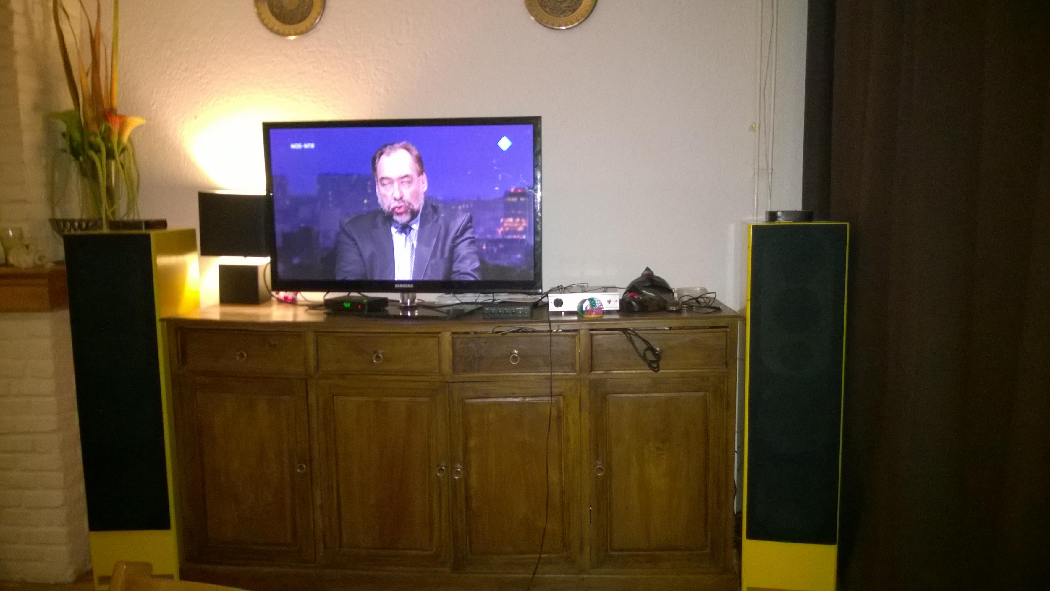

I have my old Vifa basis speakers back and connected them to my amp.
hmmmm, I'm confused, the first thing I noticed is a to much bass, my favorite groundation sounds like its to much in low frequency response.
The overall sound stage is very solid but then I got the feeling to get an equalizer to get the nice sound and with the M52's I got the nice sound feeling without thinking about that.
Listening more I find out that with the vifas's the stereo experience is way much less depended on the speaker position...... with the M52's I had to position the speakers precisely in the middle to hear the right sound, with the Vifa's it sounds great even if listening to them way of middle..... really weird.....
