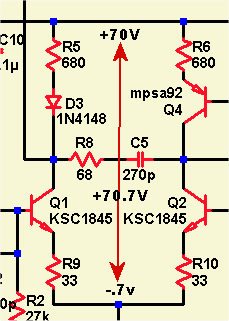

ostripper said:I try to derate
40% or more. ( 70v rail = 120 V device).
OS
You cannot use a 120V device on +/- 70 V rails [because the peak to peak V swing will be closer to 140V], for that you need atleast 150V device or 200V device with better safety margin.
I was talking about the typical self LTP topology (from the
Re's of the LTP to the positive rail) NOT
rail to rail ! (attached)
For a VAS or OPS and 70v rails , yes... 250+ is the norm.
I would not give advice to make those little devices "pop" like
firecrackers...
OS
