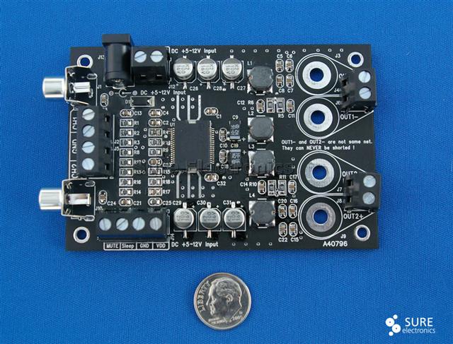

I got the first generation Sure TA2020 board nearly 10 years ago and modded it per this thread:
http://www.diyaudio.com/forums/class-d/112395-sureelectronics-tripath-boards.html
I have since also fooled with the Arjen Helder TA2024, the Sure TPA3110, and the TDA7297.
The TA2020 remains my favorite and has been in continuous use since. None of the aformentioned boards have been able to displace it from its hallowed spot in my garage. The amp has great detail and adequately drives speakers with efficiencies as low as 86 dB. It has that extra bit of magic that sets it apart from the others.
The TDA7297 is decent, has great bass, but does not have the detail of the TA2020, but well worth acquiring for $3.00 shipped, at that price, why not? I have the through hole version with the silver heat sink, common as beans on eBay.
The Sure TPA3110 is thin sounding and I wouldn't recommend bothering with it.
