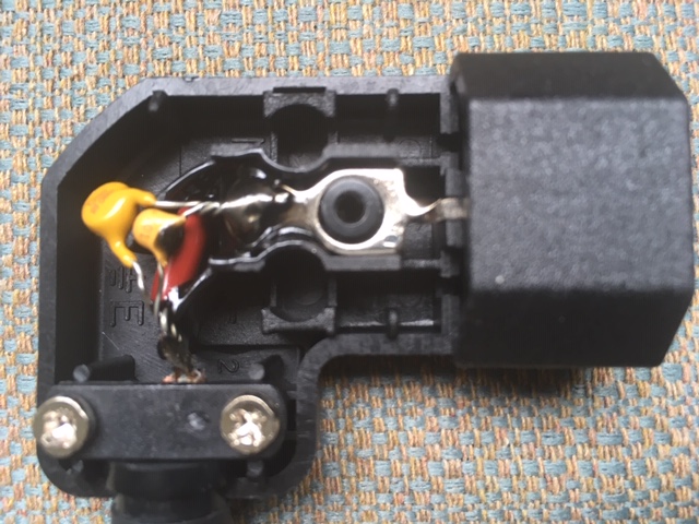

PS: Let's all hope that the Y caps show decent longevity.

You can remove the leakage current from the ipower by grounding DC outer barrel to PE. I used an EMF meter on the ipower, high levels iclose to the body of the wall wart and it follows through the cable at similar levels. Applying the grounding using iFi's groundhog connector this disappears, EMF levels along the cable fall back to background levels (still high at wall wart). The groundhog connector is available from iFi for ~$12, I emailed tech support and they sold me the connector, so are fully aware of the leakage current issues. Opening it up connection to PE is via a self recovery fuse (~160 mA trip) and a ceramic 100pF low esr capacitor plus another polypropylene capacitor (?), overall resistance to ground is ~16 ohms (see picture).
