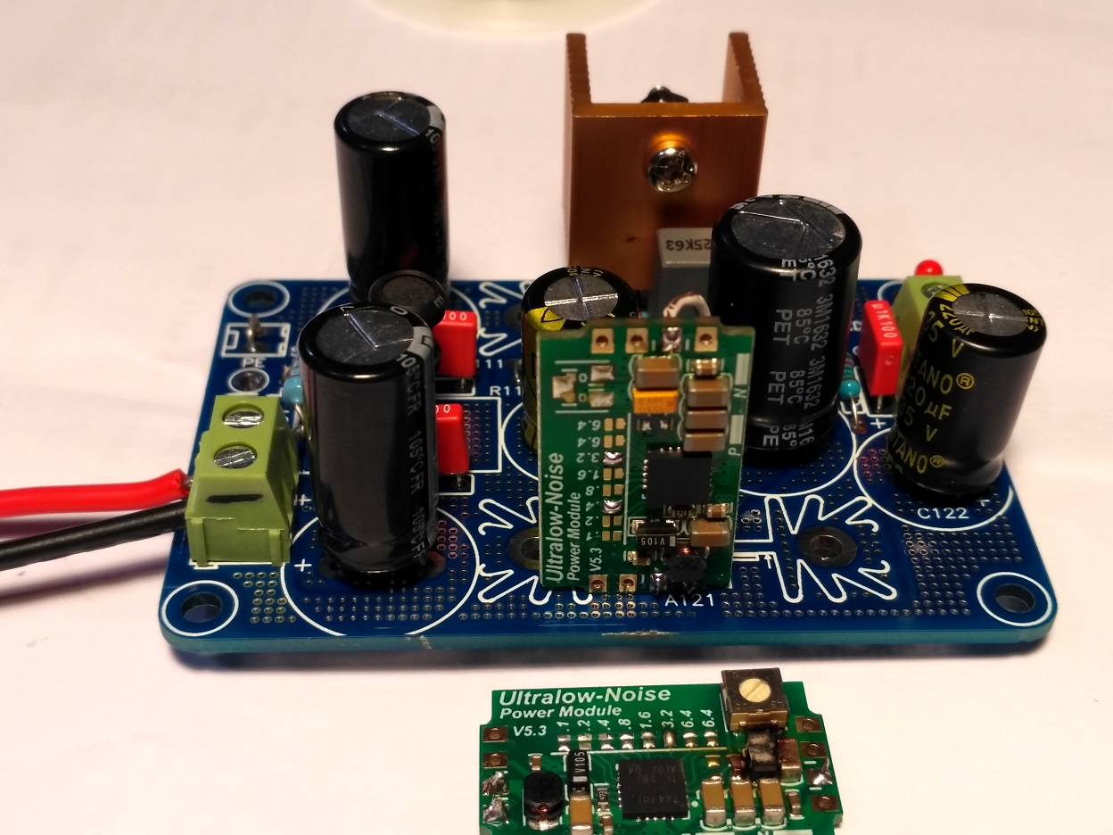

Here is mine, also 4uV rms, set to regulate at 5V ready for my TDA1387 Matt Garman dac build. Fed from a 19V router smps. No fancy aluminium case (yet), cost is less than $30, including a DC DC step down converter. Lots of stock available. You can get boards here:
GB for Simple Cap-Mx Regulated Low-Noise PSU

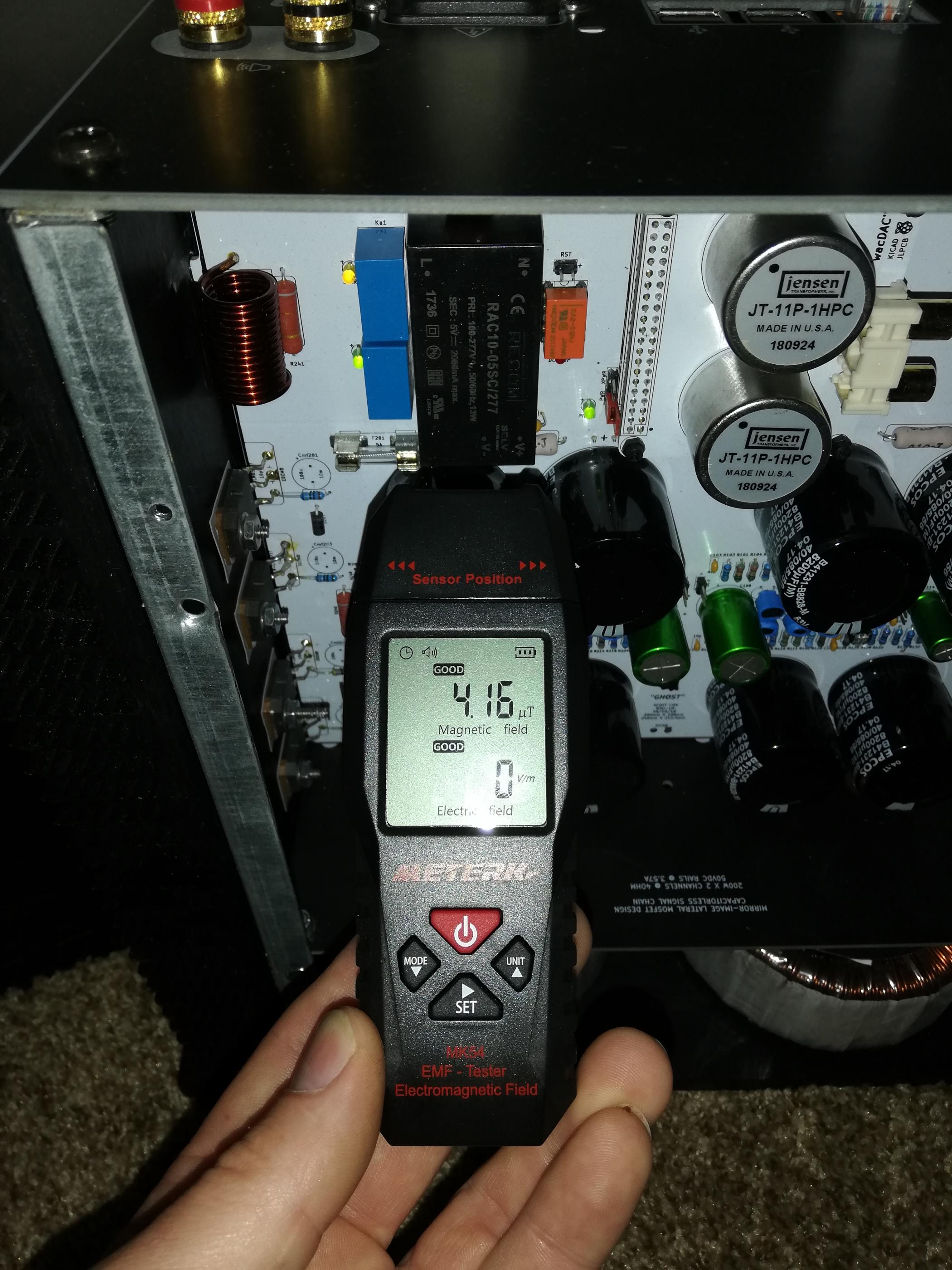

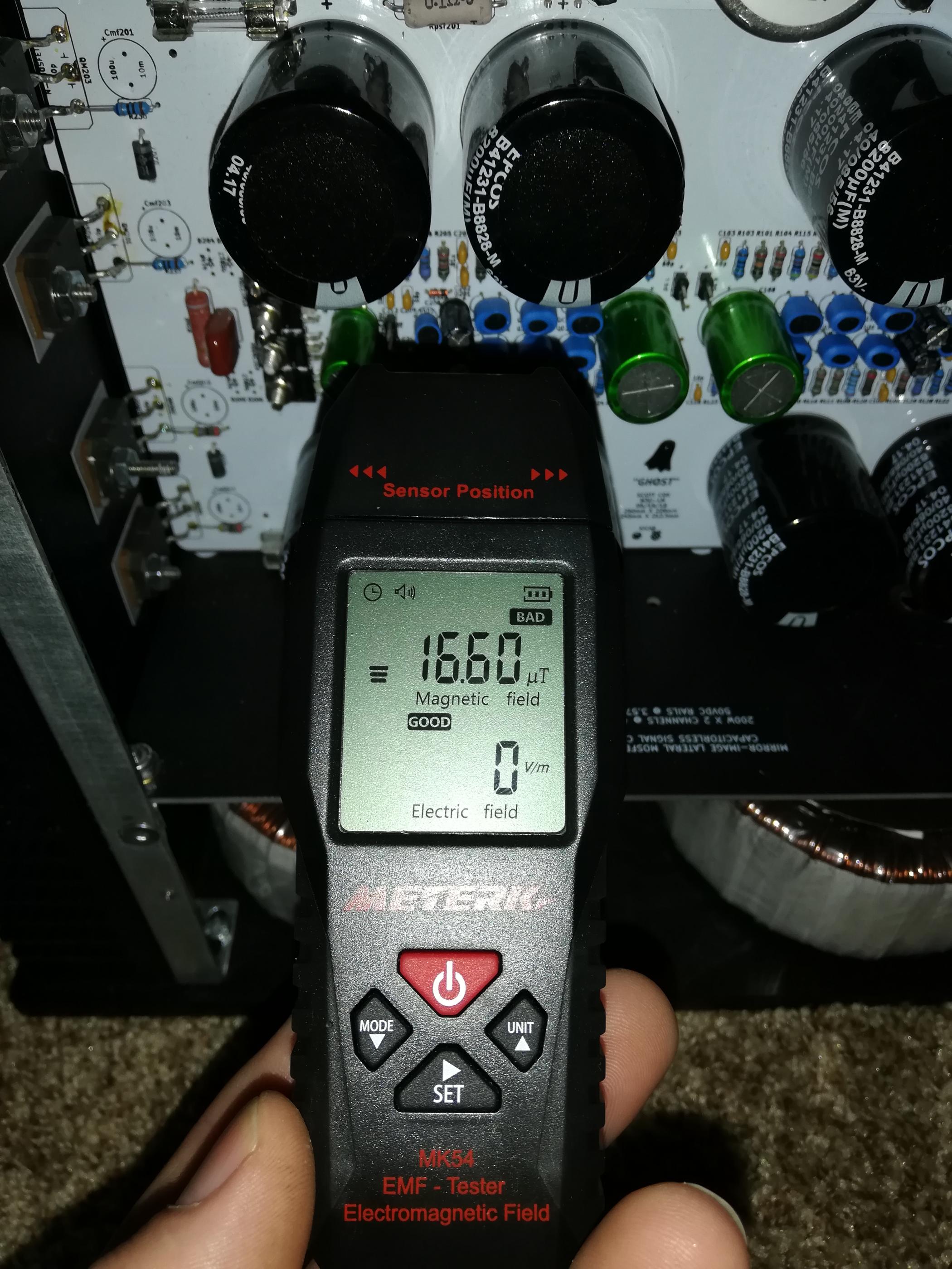

Using my EMF and magnetic test meter, the EMF doesn't extend very far from the SMPS, compared to the magnetic fields produced by transformers. The EMF is really nothing more than what you get from the power wires that go through the chassis. The magnetic fields I am working with on my project, using a combination of materials, steel being one, and I will test in conjunction with a sheet of mumetal if necessary. In my project, using a Raspberry Pi, the EMF was very high before I had disabled the on-board WiFi. The SMPS is practically nothing in comparison to the WiFi. I also plan to add another +-15v SMPS for future with no reservations about doing so. I am much more concerned about the magnetic fields because I plan to move my input transformers closer to the power toroids. My requirements are equal or less magnetic flux, more likely less with some steel and possibly mumetal shielding incorporated. EMF is nearly non-existent after disabling WiFi. A good choke filter, some caps, clean regulated down, more caps and your'e good. My system is un-attenuated, the only volume control is the DAC itself and there is but the slightest 60hz sound that you'll try hard to hear with your ear up against the speaker, the amp power supply. Even that will disappear on the final version. Nothing to do with the DAC or input whatsoever.

A good PSU and DAC/source should not have any audible mains buzz/hum even with ear pressed to speaker. Imagine if it were a headphone amp. If you can hear buzz with ear, that’s about 1mV to 1.2mV rms for typical sensitivity speakers. Connect a DVM to your speaker outs and measure AC mV.
It may be a ground loop as SMPS have nice feature of pushing mains band out to 200-400kHz where it is easily and steeply filtered.
One meter reading 0.0 mv range and another .001mv
Both ground plane and power supply will be redesigned for better isolation. It's extremely faint, at the edge of hearing. 60hz. Originally I hadn't intended to use input transformers and now can completely isolate systems now that I am. There will be no way of ground loop. To get an EMF reading, I must put the meter on the smps, while, just now, I left it on more than a foot from my phone and was reading high while my phone accessed the network. Inside my chassis, the meter reading magnetic fields high, not EMF. Even though, I will be isolating better both Pi and amp supplies.

Nice work Twocents! I see you managed to fit the eBay TPS7A LDO regulator board onto it. I see these other ones with heatsink and pins already attached. I think the extra pins are optional sense pins and can be removed for 78xx format TO220 style 3 pins.
TPS7A4701 Low Noise RF LDO Regulator Power Supply Module 1.5V-34V 3.3V 5V 12V 1A 699923682709 | eBay
These are about $12 ea.
I had problems with those kind caused by trimpot. There are few sellers having upgraded version with multi turn trimpots on the boards.

For me, an important aspect of a low noise PSU is the ability to slowly turn on with a ramp up voltage and gentle ramp down. This is a PSU and not an audio amp output stage. The soft start allows SMPS to cope with massive in rush that loading downstream caps would normally cause - usually leading to auto shutoff on the SMPS. A capacitance multiplier in series right after the SMPS but before the downstream filters and regulators gives this functionality. It also prevents turn on/off pop noises from speakers or headphones. Generally reduces transient damage that often occurs when switching equipment on and off.
The simple low noise cap Mx PSU that I mentioned earlier does this - member Twocents has beta tested it on a DAC and RPi and his subjective impression is that it is quieter than other supplies he has used.
Here is version with TPS7A4xx 4uV rms voltage regulator. You can use your choice of regulator or bypass and just use cap Mx which cuts ripple by 50dB and has a soft start feature (approx 10 seconds to full voltage).
738916d1551120241-5v-smps-xrk-psu-low-current-ultralow-noise-5v-jpg
Production boards are ENIG finish and have a green solder mask - not massive vias for double plane low impedance current paths. Uses standard screw terminals or can be wired for flying leads.
740982d1551891630-gb-simple-cap-mx-regulated-low-noise-psu-simple-psu-v2-jpg
