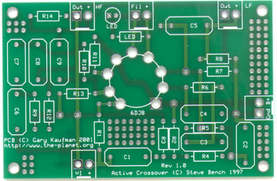

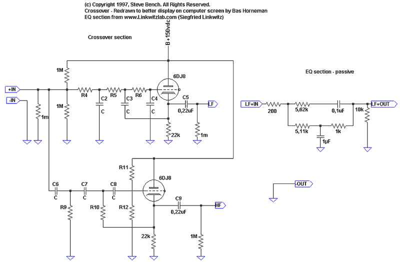

Easy enough with the EQ. The rest is gonna be built on circuit board by Gary Kaufmann. Any ideas? ..or should I just put it all together with clip leads first...and build the final version on the pcb...Guess the last option heh
The preamp is transformer coupled with 600ohm output impedance...(Just for info..don't know if that is useful to know or not)
Bas
Why should I buffer?...just curious...I'd hate to put even more circuitry between pre-amp and power amp.buffer the input
Bas
If you're certain about your low source impedance, then the buffer may be superfluous. I'd still be inclined to use it- a sonically transparent buffer is no big deal. And, of course, you'll need to be sure that the input of the next amp in the chain is sufficiently high that you don't have to buffer the output.
One way that I've used to construct circuits that will be tuned is to build the board, but solder turrets or flea clips or some other sort of terminal in the holes for the frequency-determining components. That way, the components can be soldered and unsoldered from the top of the board with little danger. Some EQ designs even put those components on a plug-in header, but I'm always nervous about adding plugs and connections in the signal path for reliability reasons.

On the original Steve Bench schematic..the specs are as follows.
Input impedance smaller than 10k (Check)
Output impedance larger than 100k (Check)
So no buffers needed.
This follows Bas's first law:
Keep it as simple as possible!
