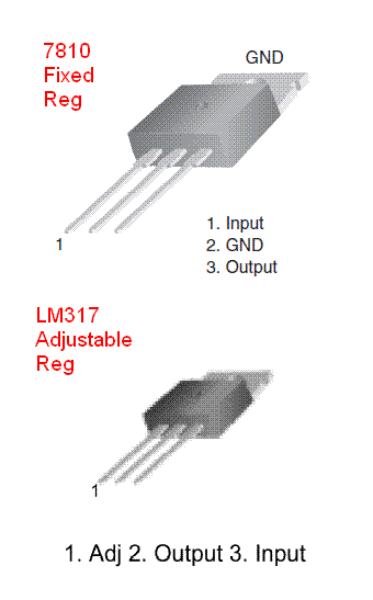

Sranang_Boi said:
The LM386 is however my Achilles heel. The IC is quite noisy and has a less than respectable profile out there. But I just can't find anything as a direct replacement. I did find the TBA820 that is almost similar and I made a veroboard based circuit that I then dropped in the TC-7510 as a replacement, with the necessary mods. But the noise level of the TBA820 was identical to the LM386 . Weeks of research and circuit building just to end up with the same result as before.
So here is my question to the community: with a line voltage of just 10V to the headphone circuit, what practical headphone amp cct could I design to take the place of the LM386?
Probably should first consider cleaning up the 10V line -- this uses an LM7810 regulator. If you pop in an LM317 with 120R/820R and 1uF/16V bypassing the adjust pin you'll knock the noise down immensely. Note that the LM317 and LM7810 are not pin-for pin. The fixed value regulator is "Input Gnd Output", the LM317 is "Adj Output Input" (Not trying to be pedantic...).
The next thing to do is attend to the 5V regulator...
