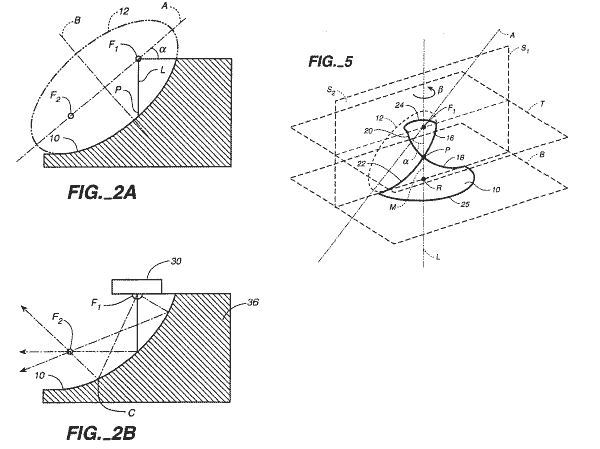

I think the Beolab 5 design is has edge diffraction problems. You'd better measure them befor you consider cloning. The las time I listened to a pair, it sounded harsh. Don't know whether it was the ICE amps or diffraction.
You will get quite the same frequency response for 180 degrees, the trick is what design will not cause aditional acoustic loading on the driver, especially the mid range. Also the edge diffraction will effect the sound and imaging.
If everything is modified right, the shape will not look as attactive, but the sound will be quite relaxing and smooth.

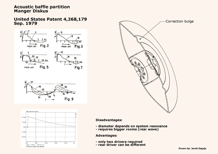

mmmmkay ive decided on building my first (of 3) bang and olufsen speakers for my bedroom. they'll each have 1 tang bang titanium 3 inch driver, an ufo plate and the sound dispersion thing on top. since today i had no school i went to my dad's job and screwed around the autocad software for about 3 hours and ended with the plate and base. they look pretty cool. currently they're being sanded. i just wish i had a camera......
The construction of deflector is simple - see attachment. Using top quality dome tweeters is interesting since they have best waterfall available so far (see Dynaudio Esotar). Nevertheless I will try such deflector with 50mm full range Bandor because my primary enclosure would be a bipolar infinite baffle (disc like) so that it can be easily rotated to mimic Beolab design.
Looks like some drawings out of a patent, do you have the number? I've done something like that with the Jodans, and you will see some baffle diffraction effects in the response. Additionally, do to the wider high frequency radiation pattern, you will see some drop at the top that needs to be compensated for.
Here you are: 5615176
I'm not sure how the diffraction looks like on the frequency trasmittance data but know we can use spatial averaging to extract such component. What I want to do first is to eliminate small pressure changes on the step response.
I think we still cannot point where is a subjective differences between Manger MSW and Jordan JXR6 on the graphs.

There are two sources of diffraction, the upper edge and the lower edge. and there are two times the diffraction will take place if not carefully handled, the direct radiation and the reflected radiation.
I'm not sure I understand this statement:
"I think we still cannot point where is a subjective differences between Manger MSW and Jordan JXR6 on the graphs."
Edge diffraction is of a transient nature, although normally we review it though frequency domain, but to try and correct it electronically probably is very difficult or probably impossible. I recall Acourate is a microphone modeling software, do you have a web site for the explanation?
