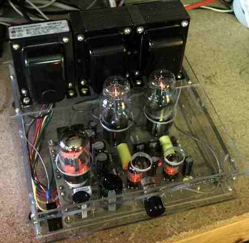

I do not notice that anyone mentioned vacuum varnish impregnation (a particular brand of varnish, name not known to me - trusted my transformer manufacturer on this one).
Having seen my share of failed unimpregnated/unvarnished transformers through copper oxidation over the years, that is not an option for me, especially for a (say) $150+ output transformer. It will increase internal capacitance somewhat, but I could never not live with that. Laminations are thus sealed, especially necessary in C-core types. I personally bolt my transformers onto the chassis, then shroud them (separately onto the chassis) for aesthetics. I have occasionally had to mount all 3 transformers close to one another without noticable hum being introduced.
(Please note that some hum introduced when testing with a passive OPT, will be damped by the tubes arrangement when those are conducting.) In my experience power transformers varied widely regarding their stray field. I once found one with the well-known copper foil stray field shorting ring round the core to be worse than another without it. I also once had to reject a power transformer (well-known make) and buy a different one because of the severe induction. (The best position for the former was at a peculiar angle in space.)

In Aug this year I potted a locally available 50W PT to a black square steel can which a lid at bottom to be screwed to the can with commercially available 2-comp. Epoxy resin but the filling is not completely hardened until now with many tiny bubbles in it. I was suspecting the quality of the resin so I mixed the resin and hardener(1:1) on the bench and found it hardened very well. My guess is impregnated varnish to the PT keep the Epoxy from hardening.
If I am correct, which potting material would you suggest?

Take a look at a common garden variety Fender, like a Bassman. This orientation has the least possible coupling between power and OPT. And, they placed the choke in between the two, another plus. The basic floor plan, for those without access, is that of a T. The upright is made from the power transformer laying on the face of the laminations, with the coil protruding through the chassis. The power transformers (E/I types) core has the short side aimed at the OPT, with the long sides at right angles to the OPT. The OPT is standing up, with it's long core side parallel to the chassis and crossing the upright as a T cross bar.
For E/I transformers, the strongest emissions will come from the center of the long side of the core lamination stack. The short side will be a factor of about 8 times less, with two nulls right at the E/I joint. The coils face will be 8 times less and the joint between coil side and lamination face, another 8 times less strong.
