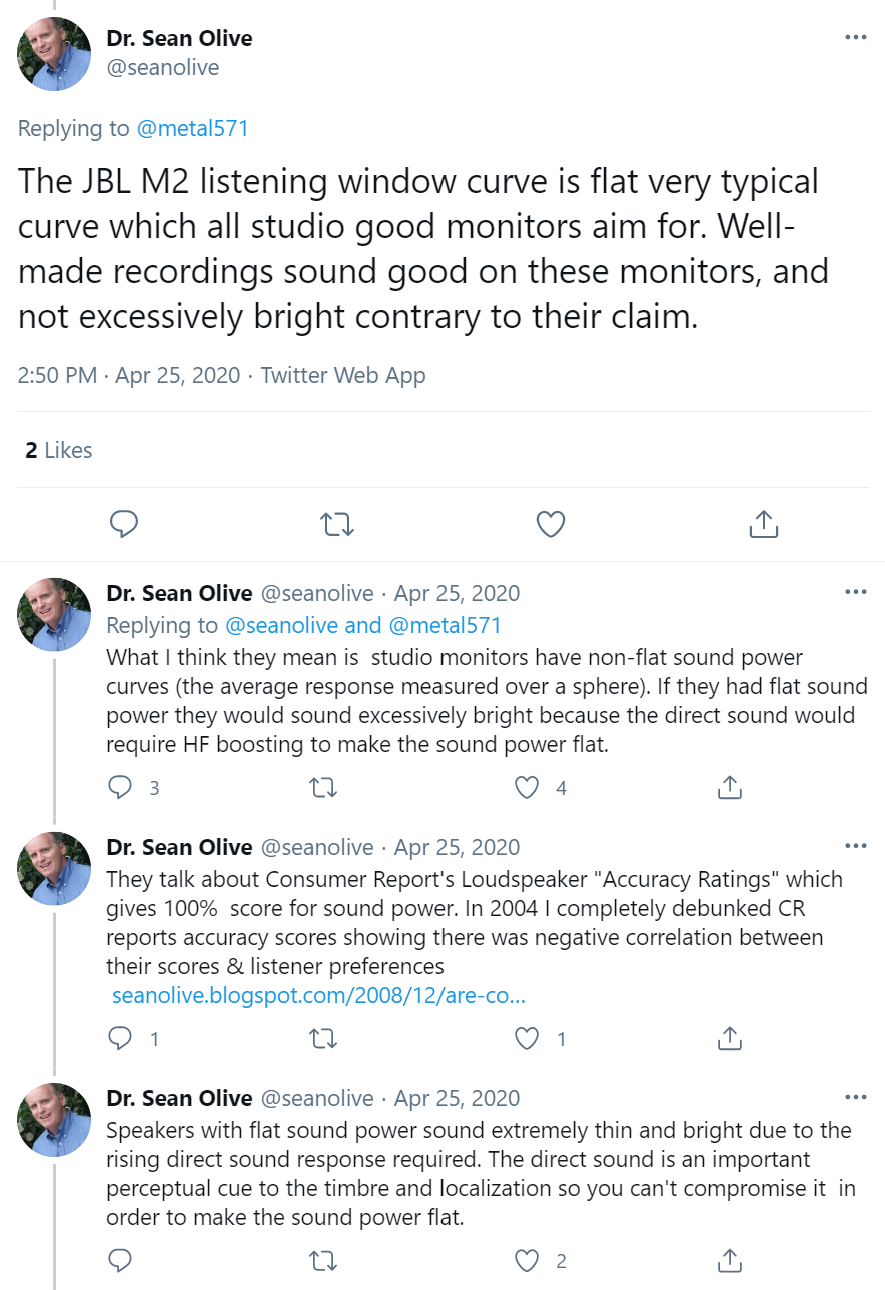

Sean Olive said "well-made recordings" sound good on the M2 (and similar studio monitors). So maybe there's no problem with the model but with the program material. He also thinks recordings are the main problem with audio today.
"The main problem with audio today is the lack of quality control in how recordings are mixed and monitored. There is no quality control or meaningful standards that define the performance of loudspeakers and rooms in which they are made and reproduced. A common loudspeaker standard shared by the professional and consumer audio industries would significantly improve the quality of sound" - Sean Olive, 2016 Sound and Vision Interview, page 1
He also said this on page 2 regarding the M2
Given JBL’s professional heritage, we place more emphasis on accuracy, efficiency, and how loud it can play without distortion. For the JBL M2 reference monitor, this is achieved by using a high performance compression driver, woofer, and waveguide optimized to produce a flat, smooth, and extended response. For Infinity loudspeakers, accurate sound is the goal, but there is less emphasis on efficiency and maximum output.
Earlier in the thread TBTL explained the M2 advantage was it could play loud. So maybe the only way for the M2 to outperform the Salon2 is to turn them way up.
If we knew the conditions under which the M2 could reliably beat the Salon2 it would help.

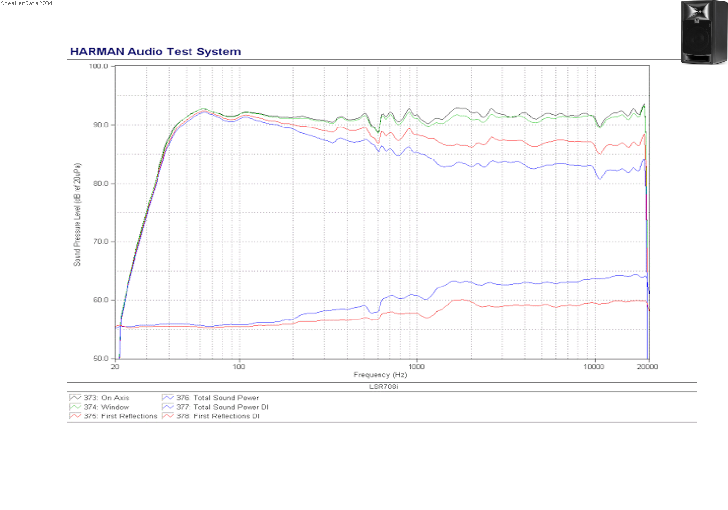

Again, I'd love to see the spinorama data compared for these two products.
I think that playback level is also a big factor because we know that things like diffraction become more audible at higher SPLs. Many audiophiles simply reject the idea of high volumes. I remember a lecture by S. Linkwitz where he described how he designed a system based on an 85 dB level. I asked if his analysis would hold up at higher SPLs and his response was that he doesn't listen at higher levels.
The M2 has a much smoother frequency response and a higher and smoother/flatter DI (especially around the critical 1-3 kHz range). Those are both winners to me. The only thing that I might change is to flatten the DI above 8 kHz and then a slow roll-off of the direct sound above there. Room sound power stays about the same by the direct sound isn't so harsh as can get with directional sources. This seems to many to be a little better approach than the ruler flat direct and with a rising DI. But that's a much more complex argument to get into.
