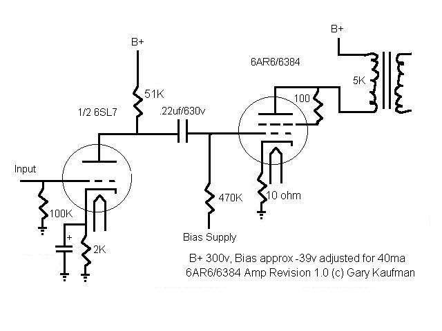

At the risk of being circuit-slapped for not being able to check right now, does anyone know of a schematic for a good design for these tubes?

If you add a transformer for heater current then just rewire the tube sockets for 6384. It is an excellent tube. Why use converters ? You won't be going back to 6L6 and 6384 lives very long. If you have more of them it is of course better to keep some spares.

I have one word for you. 7581A. 6L6GC characteristics, 35 watt plate instead of the 30 watt plate of the 6L6GC. The best part? Zero modifications required.
The 6384 is designed for military aircraft use, or anywhere there is a lot of vibration. More than a Fender amp combo puts out. The same plate power dissipation and much higher plate voltage screams for a circuit that would take advantage of those ratings. That tube is wasted in a Fender Showman. The screen voltage incidentally is 325 VDC maximum.
So this tube is not actually a good match for that basic amplifier. You would use higher voltage B+ supply along with that extra current for the heaters. It doesn't make sense to use it in your Fender 'cause it will sound like ... a Fender. Build something fresh and come out with an awesome amplifier, and a Fender amp worth it's book value. Modifying the Fender will reduce it's resale value as well.
