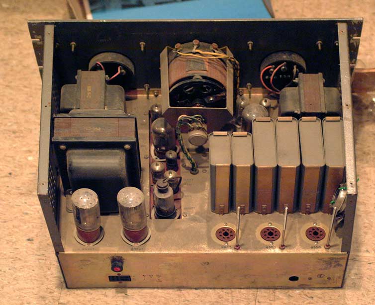

Was going to knock up a SE garage amp from 6GV8s I have on hand but I think I may build a Bench Supply first as it will probably come in handy for other projects. Other than the 120V PT for the garage amp I have only one truly high voltage PT. I was saving it for an amp but since it is only rated for about 120-125mA on the B+ winding it might be marginal for a lot of stereo PP applications I may use it for the bench supply instead since one normally prototypes just a single channel and if I do overload it in the bench supply application it would be for a very short time.
The center tapped B+ winding has full voltage tap and a lower voltage tap (maybe intended for screen supply or just for lower voltage option) on the same winding. on one leg of the B+ winding there is also a lower voltage tap for a bias supply. The bias tap is only on one side of the CT. Not sure whether I should use those lower B+ taps to provide a second output for screen supplies or whether to use it for range selection and use a separate transformer to make a screen supply output. Since it is on only one side I would have to be sure that a bias output was not loaded very much to prevent asymmetry on the B+ outputs.
It has a 5V heater winding and a 6V heater winding. It appears that there are three taps on the primary (blue. gray and brown) which I suspect are 240, 120 and 100 (Japan). I suspect I could use any of the primaries to choose different voltage output ranges so as not to over stress the pass tubes but if I do so I would not be able to use the heater windings for the tubes in the supply. Of course the same would apply for using a variac to reduce voltage range.
If I use separate trannies for heaters I could connect the 5V and 6V windings in series to provide a regulated DC heater supply output (max 7V or so).
The chassis has 3 octal and 3 9 pin mini sockets. I figure on using 1 octal for the screen supply output pass tube and the other two for parallel pass tubes for the main B+ output. The 9 pins can be used for error amplifier tubes and bias supply pass tube. I also have a few 9 and 12 pin compactron sockets that fit where the octals are so if I need to I can use some of those tubes for pass tubes.

I rang out the windings this evening and got the following RMS voltages ref to CT:
Input Black and Gray: Main 178V, Screen 137V, Bias 24V
Input Black and Blue: Main 322V, Screen 261V, Bias 46V
Input Black and Brown: Main 386V, Screen 314V, Bias 56V
So pretty good range of voltages.

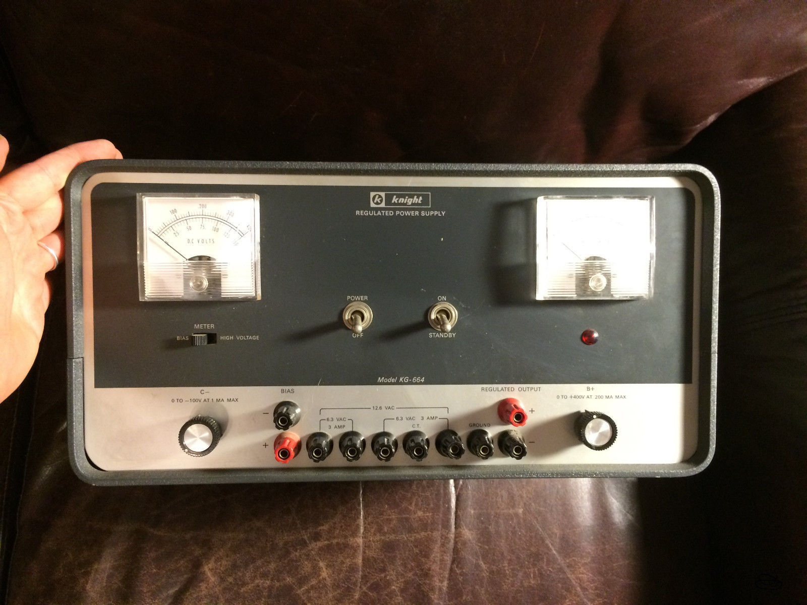

For now, I would build something like this. One of the dino's on my bench is this KG-664. I got it used at a hamfest for $25 maybe 20 years ago. It finally died due to being left in an unheated building during last years winter when it hit -12 degrees. I replaced all the electrolytics and it is live again. I routinely overload it to 300 mA or more and often hang a 100 uF motor run cap across the output without issue. It is rated for 200 mA. Leave out two pass tubes for a 100 mA version. Rectification is SS, you can substitute 5 watt zeners for the VR tubes.

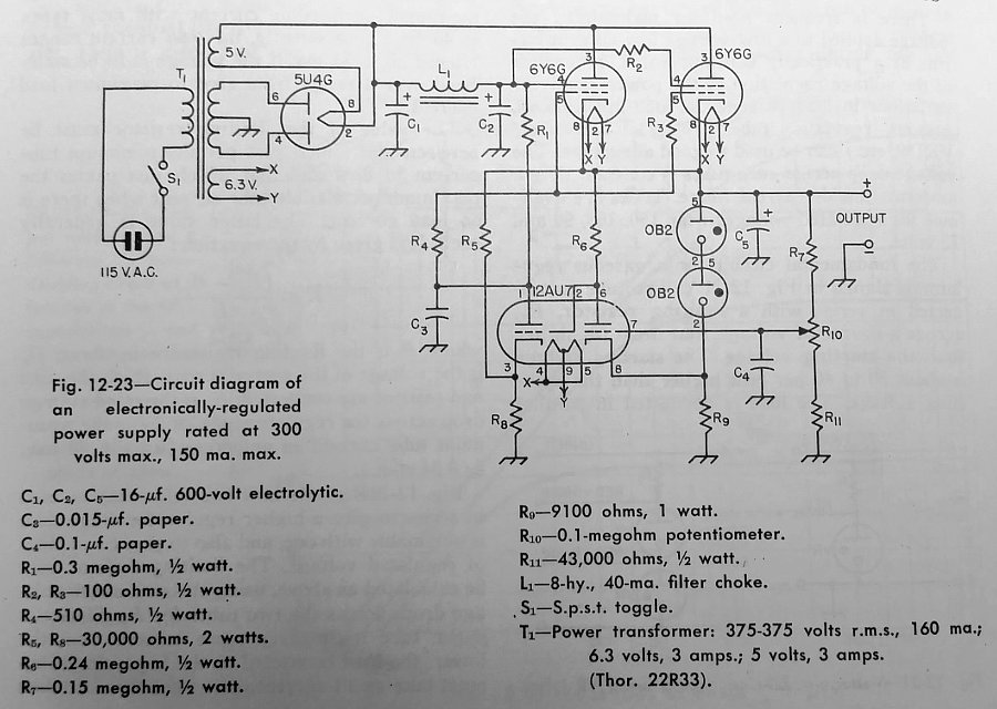

Here's a schematic that might be useful -- from my archive. Unfortunately, I haven't always been good about noting sources. It might have appeared in one of those big Markus books.
I have an ancient Lambda that looks similar. I don't think too many manufacturers used 6Y6's as pass tubes.

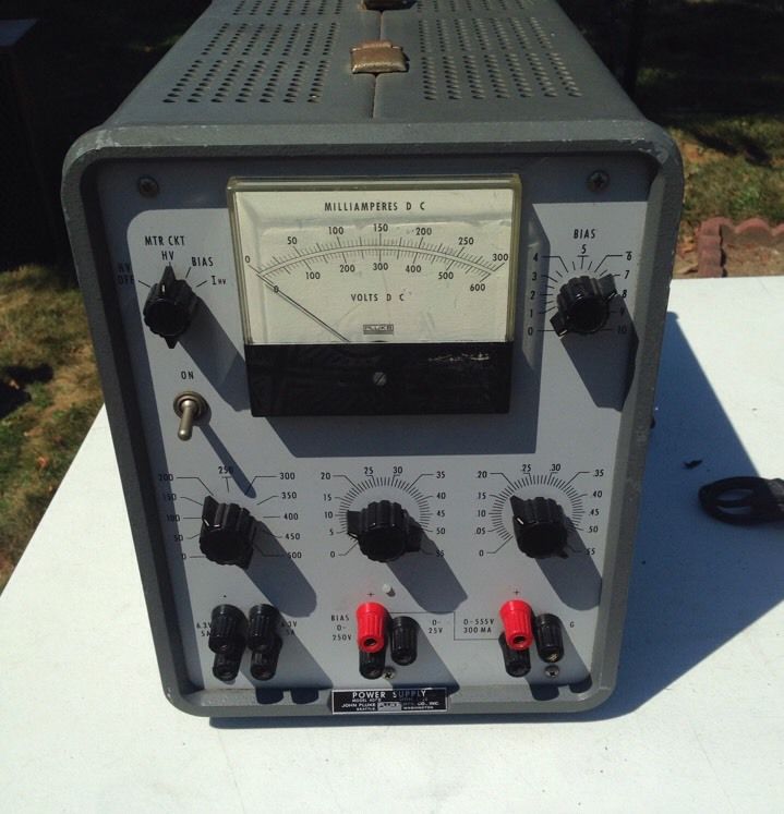

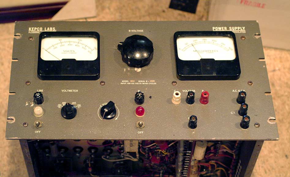

I've got a couple of these Kepcos. 0-600 volts at 300 mills. These things are built like tanks and never really die. This one may just need a delay tube. They use 6336's for series pass tubes and 5R4 rectifiers. Yes, it's a boat anchor.
Knight KG-664 $250
(2 pics) Kepco 615B $175

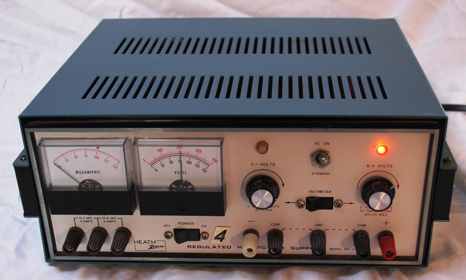

Heath SP-2717a $115

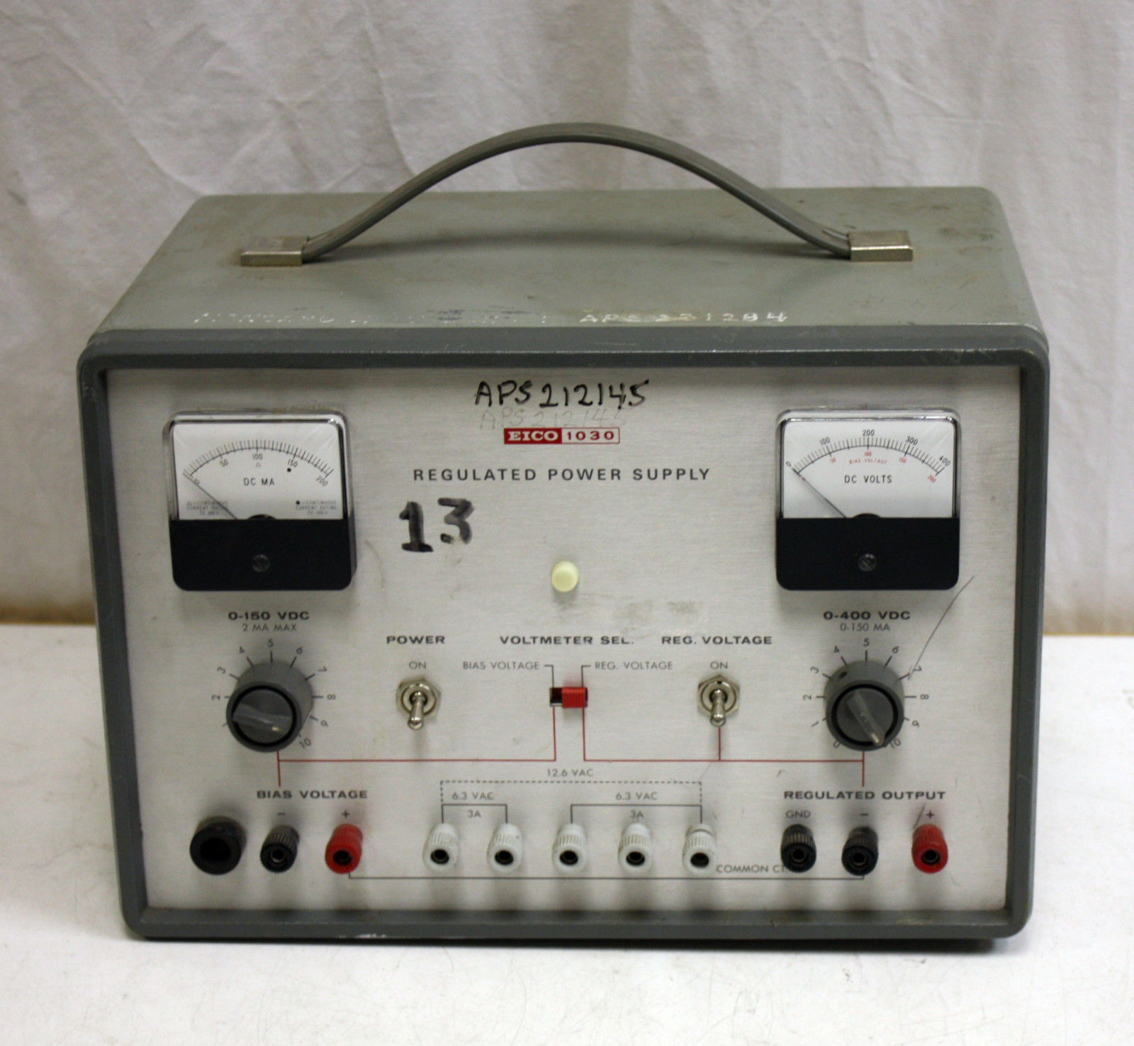

EICO 1030 $100

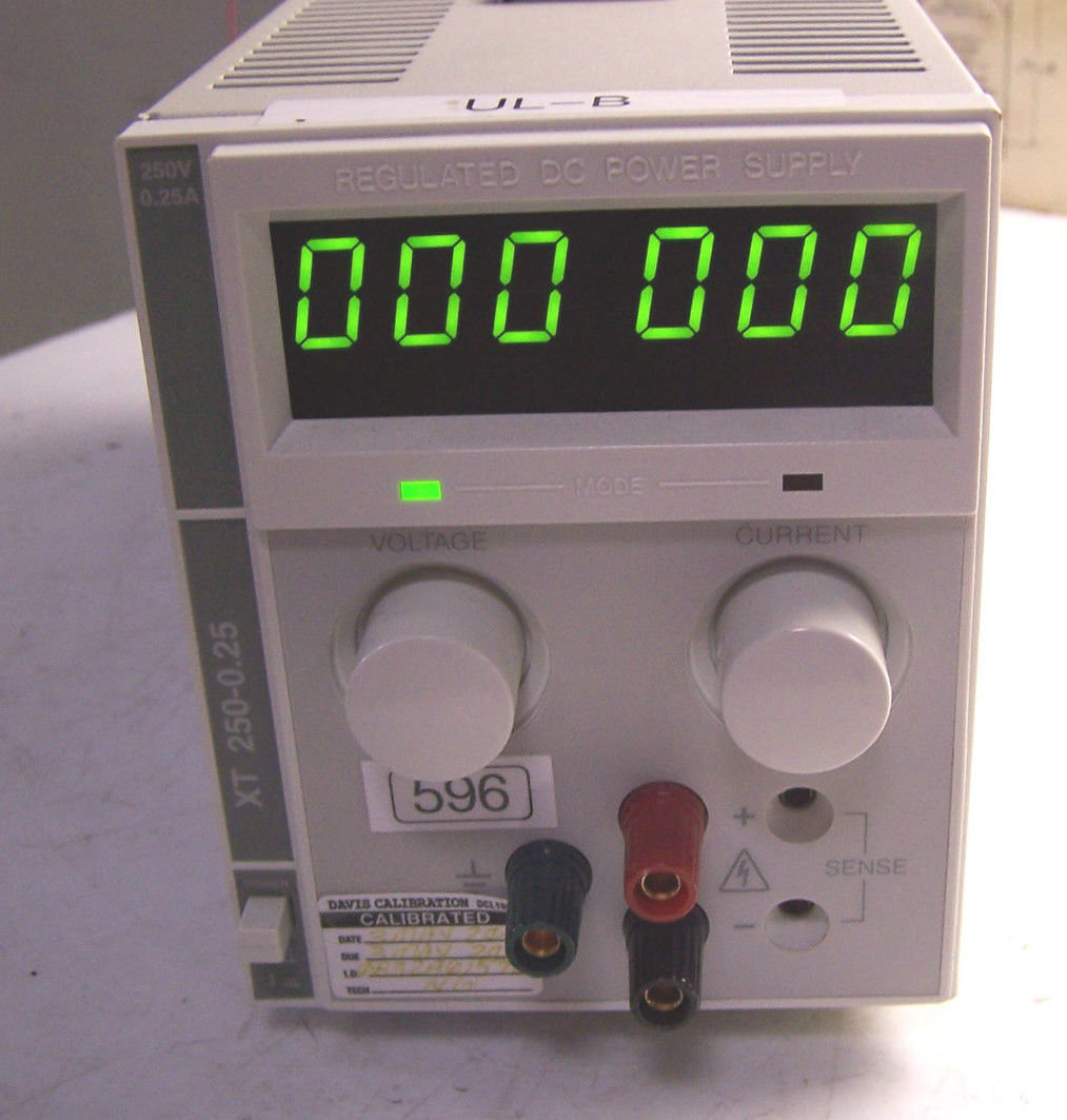

Xantrex XT-250 $110

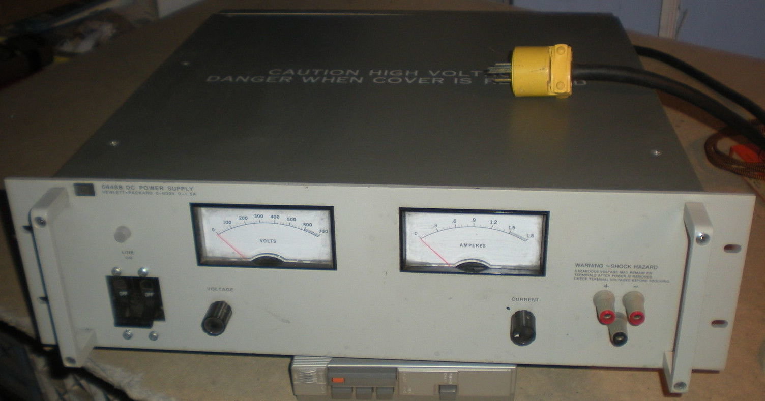

HP 6448B $250 (900 Watt, SCR phase control, heavy xfmr, 60 lbs)

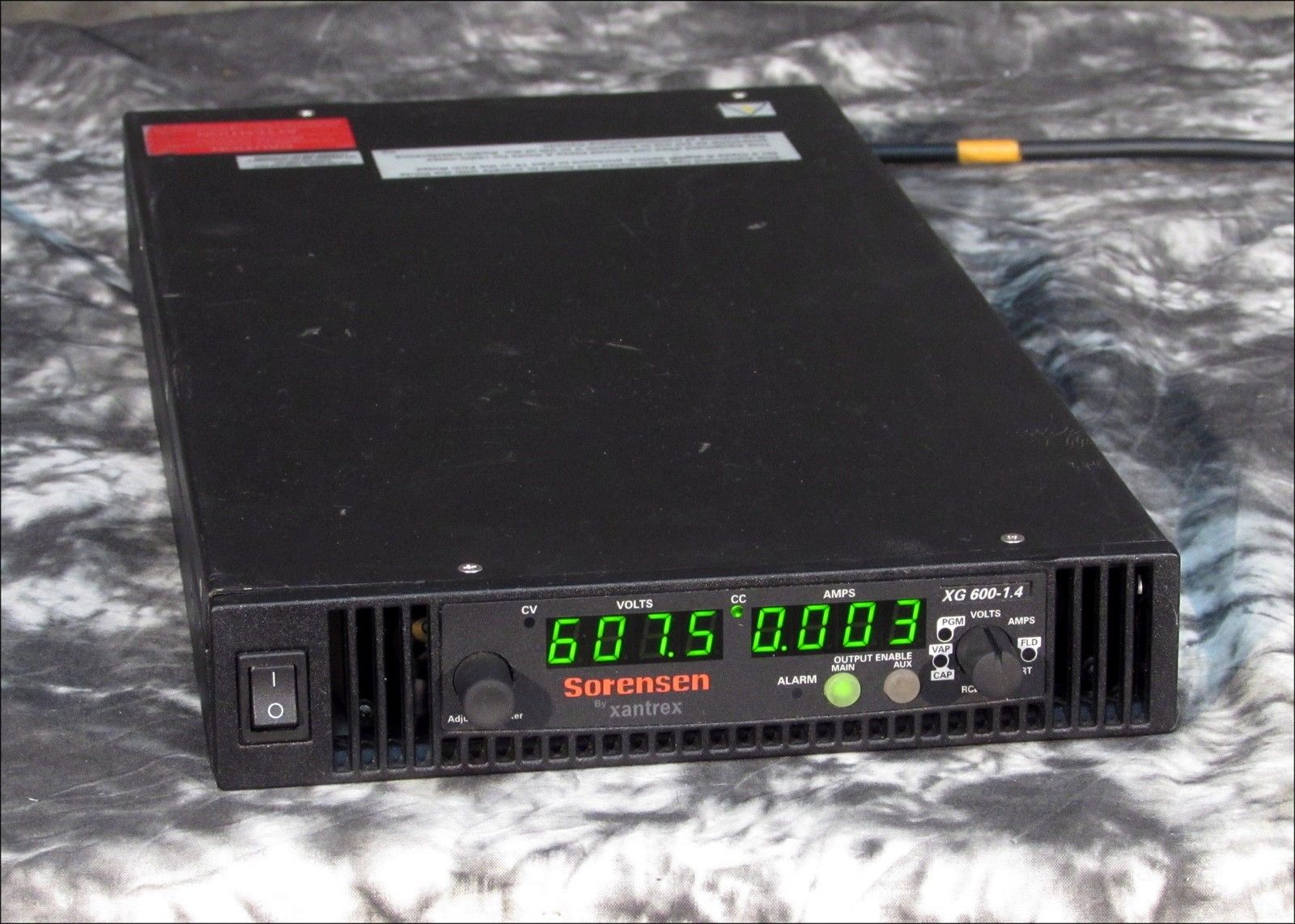

Xantrex XHR-600-1.7 $300 to $1000 lately (used to be $100 a few years ago, HF switch-mode, 600 or 1000 Watt models, 11 lbs, digital readouts, isolated PC digital interface, compact) (this is what I have)
Xantrex XG and XTR 600V book size power supplies, $1000+

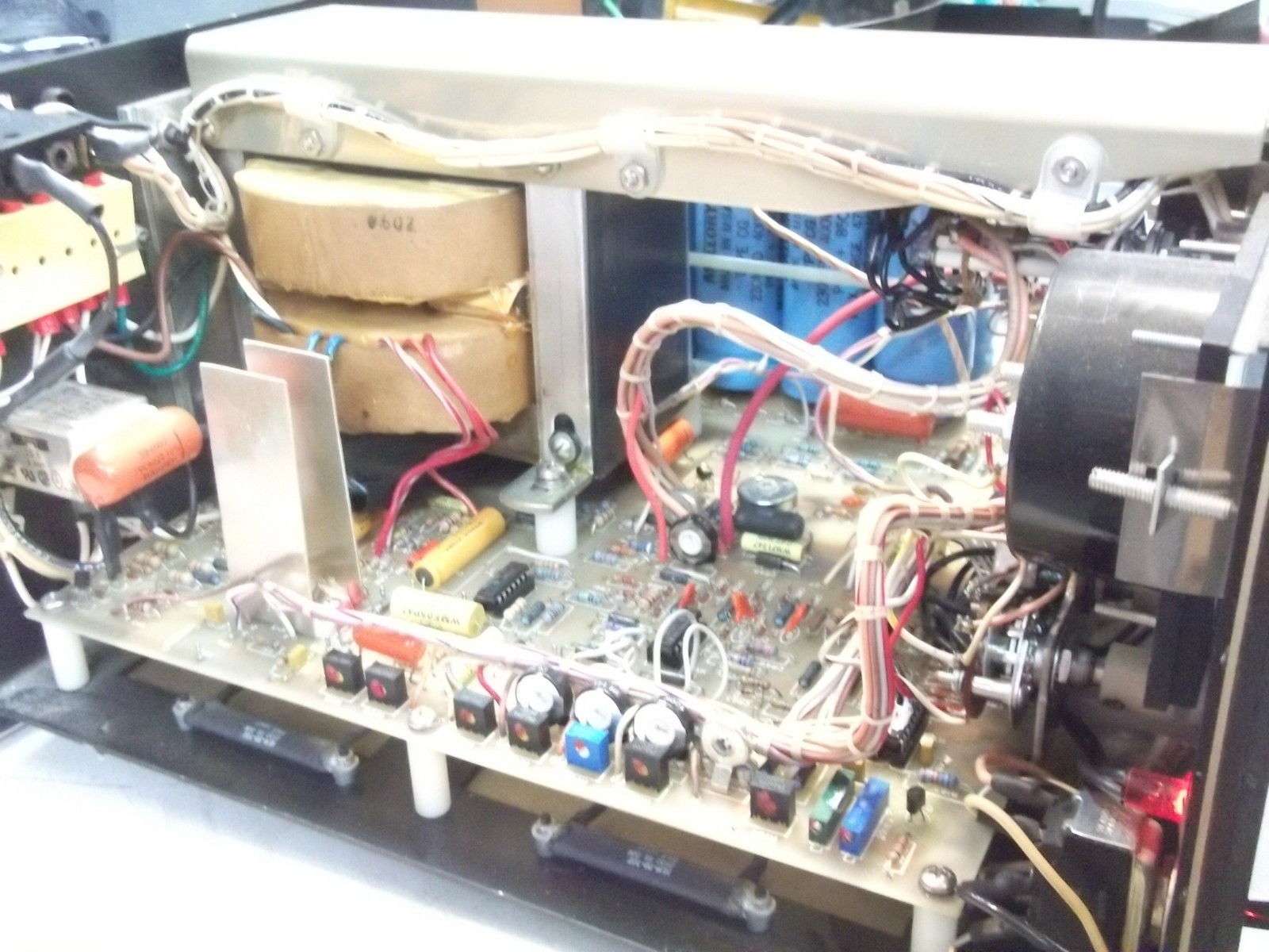

I would take one at that price but it seems to be quite a bit more these days.HP 6448B $250 (900 Watt, SCR phase control, heavy xfmr, 60 lbs)
Here is a "fix-up" HP 6448B for $250. Not that much to them actually. (xfmr, SCR, capacitor, control circuit) But I would get a newer Lambda TCR-600 for cheaper. (same SCR design)
