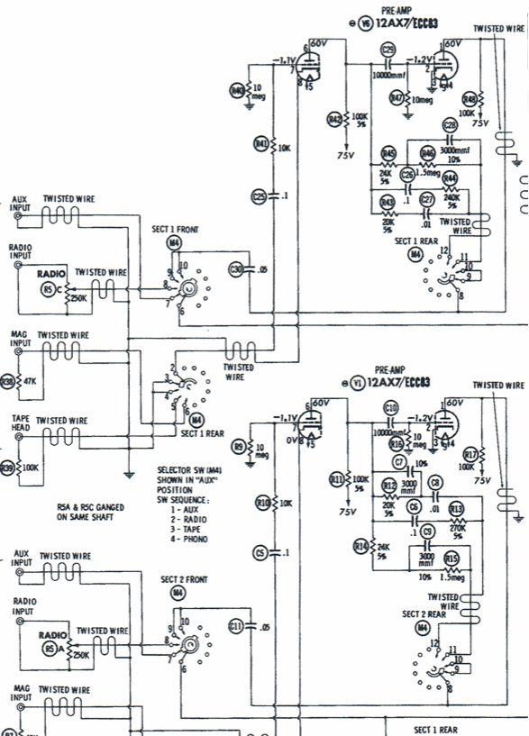

Making a list of the components I needed and looking at the schematic to get an idea what to do first, and what components can be replaced together, I noticed that the Left and Right RIAA circuits are different ??
This model also has an eq for the tape head input ( THE original Bell 3D Didn't have a tape input, but this later 50's model did and was renamed the 3DT, Anyway). The tape eq circuit is the same for both channels, and this is implmented with the selector switch, which has a separate wafer that loops in a different feedback loop for each of the tape head and, phono inputs.
TAPE EQ
On the attached schematic the right channel (top) uses C45, R46 and C28 to EQ the tape head, this network is routed to "11" on the selector switch wafer "Sect 2 Rear M4" and the output of the stage, on pin "8" of the selector switch, is routed up through this network when the tape input is selected , this is exactly the same on the opposite channel... simple enough. (C7, R12 and C8 ) NOTE the schematic is drawn differently for each channel, but it is the same.
PHONO RIAA EQ
The phono RIAA network however, right channel (top) uses C26 and R44 in series and this is parralelled with R43 and C27, note that R44 is 240K. This network is connected to pin "12" of the selector switch wafer and the output of the stage is fed back through this network when the "Phono" input is selected on the selector switch. (And the tape EQ network left Open Circuit)
The left channel is ALMOST the same ... using R12 and C8 in series and then paralled with C6 and R13, but note the difference, and extra component.
R13 is 270K (but 240k in the right channel) and R12 the 20k resistor is shunted with a 3000mmf (3000 pf, the schematic is that old that they still use micro micro farad ) capacitor.
So what's up. I have looked into the bottom of the unit and sure enough this is how it is..
So if I replace these components, I'm thinking that I should make both channels identicle, using 1% metal film resistors and 5% poly caps, but what channel to copy ?
Ideas ??
Simon

So,
Nobody is curious as to why one of the worlds first stereo amplifiers had an asymetrical RIAA circuit ?
And no suggestions on which channel to use as in the rebuild, or if I should change any of the values ?

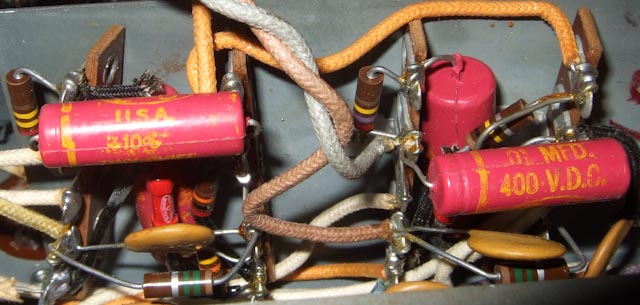

Confirmed,
A couple of the RIAA network resistors are different in each channel, but should be the same I would think.
A 240K, (Red, Yellow, Yellow) in one channel
And a 270K (Red, Violet, Yellow) in the other. As seen in the attached photo.
Also the additional capacitor that shunts the 20K resistor in only one channel is there, and visable in the bottom right hand corner of the attached photo.
So, not an error in the Sams PhotoFact. The physical components are they as per the schematic.
SO, as I replace the components in this Vintage Classic, what channel do I use as a model for the new resistors, and why were the 2 channels not identicle to start with ?

Hi DF96
Thanks for the comment, I will add a C7b to opposite channel when I replace the components. But why the different resistor values ?
The sound is fine, The Phono sounds better than the CD player. (As it should )
I was listening for a audible difference, but could not notice anything. Most of the components are 10% and after 55 years, the two channels are most likely not that close to each other anymore anyway.

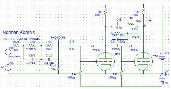

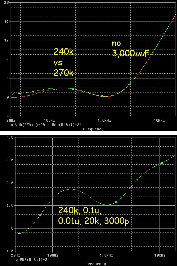

The difference 240K or 270K is a dB below 50Hz. Insignificant. Not even easy to test for on 1950 gear. While today it is routine to do parity-check, that may not have been obvious to the draftsman of the first stereo working from the prototype's handwritten notes. I have seen handwriting where "4" and "7" could be confused. They are both 5% parts. Probably a goof-up that was never noticed.
As said, the lack of the 3,000pFd is "wrong" for most electric recordings. Theories about how the forked-arm recordings were EQ-ed is beyond my ken. With any "stereo" recording and pickup you are likely to have, you do want about 3000pFd there.
> playback curve for records was not standardized.
Yes and no. Commercial consumer recordings had many published curves. Broadcast transcriptions were already an NAB standard. The RIAA Standard is essentially the NAB standard with more detail.
The hilarious thing is: w/3000p, this preamp IS the NAB/RIAA standard!! +/-1dB from 50cps to 5kc, can't complain about that. The rise above 5kc may be tamed by roll-offs in later stages or stray capacitance; IAC another dB above 10KHz is nothing compared to the tweeters of the day.
In schematic, V17 is a hack for the sim's failure to grid-leak bias as real tubes do, to get the right op-point.

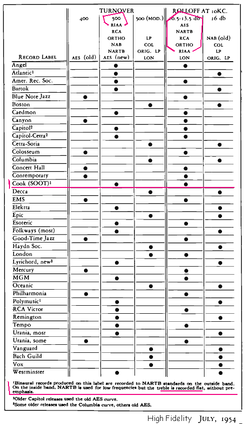

Hi folks, late reply, I think the last post was in 2011--anyway, maybe I can help answer your questions as to why the RIAA EQ was different in the left and right channels of the phono stage of the Bell 3D and 3DT. This unit was designed and built BEFORE there were the stereo records we know, and was to be used with the Cook Binaural recordings that required two mono cartridges mounted to the tonearm, with the cartridges separated from each other in the horizontal plane by a defined distance, to play these special discs, which were recorded with one channel cut on the outer half of the disc, and the other channel cut on the inner half of the disc. The EQ was different for the channels because there was apparently a problem with high frequency distortion in cutting and playing the inner grooves on the inner half of the disc due to the much lower groove velocity of these inner grooves, so during cutting, a different pre-emphasis curve was developed for the inner grooves, to help lower the playback distortion. Consequently, the de-emphasis in that channel of the 3D/3DT phono stage also had to be different in order to compensate for the different pre-emphasis curve on that part of the binaural disc.
I found this. Note the two heads on the tonearm:
PRR
Joined 2003
...to be used with the Cook Binaural recordings that required two mono cartridges.... The EQ was different for the channels because there was apparently a problem with high frequency distortion in cutting and playing the inner grooves on the inner half of the disc due to the much lower groove velocity of these inner grooves, so during cutting, a different pre-emphasis curve was developed for the inner grooves.....
Confirmation from historical publication.
