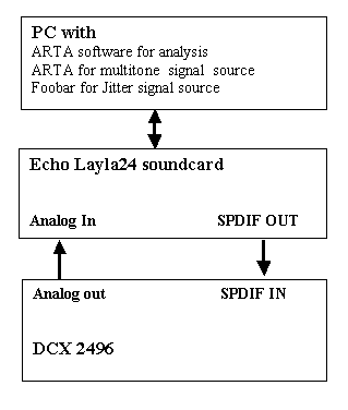

I updated my page with a graph of measurement setup.
I used ARTA software for analysis and either ARTA or Foobar (for jitter signal) to play the source signal.
The signal was feed to DCX through the Coax SPDIF out from the Echo Layla24 soundcard.
The analog signal from DCX was feed to analog input of the Layla24 soundcard.
Thus both the source signal (SPDIF) and the ADC process had the same master clock - the clock inside the Layla24.
I have a stock DCX2496 at work - I just forgot to bring it home for holidays. So I can do the comparison of Frank's mod against stock unit in two weeks or so.
Ergo

Hi Ergo,
Looking at the measurement setup I have no idea to compensate AD errors of the soundcard. Normaly you shortcircuit analog out and analog in of the soundcard and compensate the errors to a certain amount with a calibration routine. But now there is digital output used.
Frank
