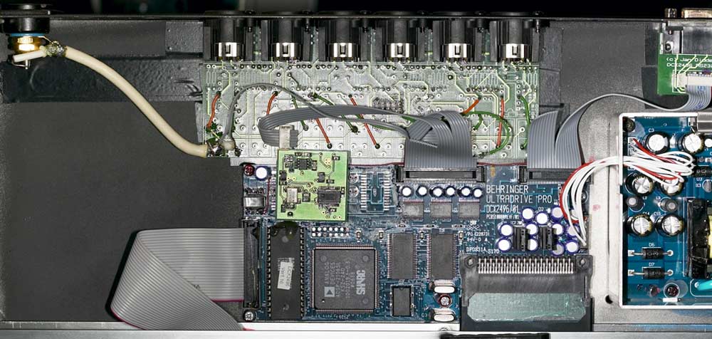

My analog mod was wiring connected to X13 connector on the DCX analogue board and was messy. So the first thing to do was to sort that out. But first I wanted to mod my CD player so I could avoid SRC and send S/PDIF signal straight to DCX.
So I conntacted Scientific Conversion here in the Bay area that makes highly regarded digital transformers. Jon Paul who is main designer and owner is very cool guy who has helped me design new output for Sony. I installed new tranceiver 485 chip with Scientific's top of the line digital transformer SC937-02 and with termination for 75 ohms. Here is the link for you for that transformer:

After that I turned to DCX. I used Jan Diden's passive board to make my analogue connections cleaner. Jans board deals only with outputs and additional RS232 sub board is there for the PC control that I use all the time. That was great for me since it omits all of the inputs that I do not use at all but digital in only. I do use occationally C input for auto delay calibration, but I have second DCX that will be great just for that purpose when needed.
So I proceeded with that mod, did all the flat cables and volia - that was done. Next I got Neutrik RCA connector for my 75 ohm coax S/PDIF input, and smallest Monster digital cable to rout the signal. I used empty space on Jan's board to have cable secured and wired to 1 and 2 connector on X13.

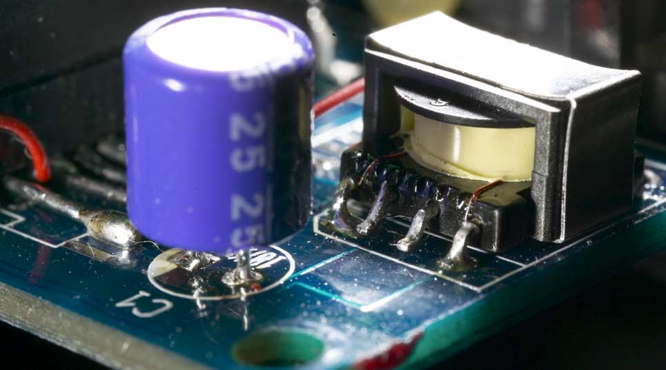

Next in line was Transformer and AES/EBU 110ohm termination resistor replacement. In the place of original transformer which was through hole, I placed Scientific Converesion's small beauty which is SMD, but almost perfectly fits in the place of original transformer. That little guy, unlike original one is shielded and it provides shielding connector. I replaced 110 ohm SMD resistor with 75 ohm that is located on the bottom side of the DSP board. Scientific has through hole transformers, but Jon was clear that this small guy is just the best performer overall. So, that was done.
Lets have some pictures than I will continue.

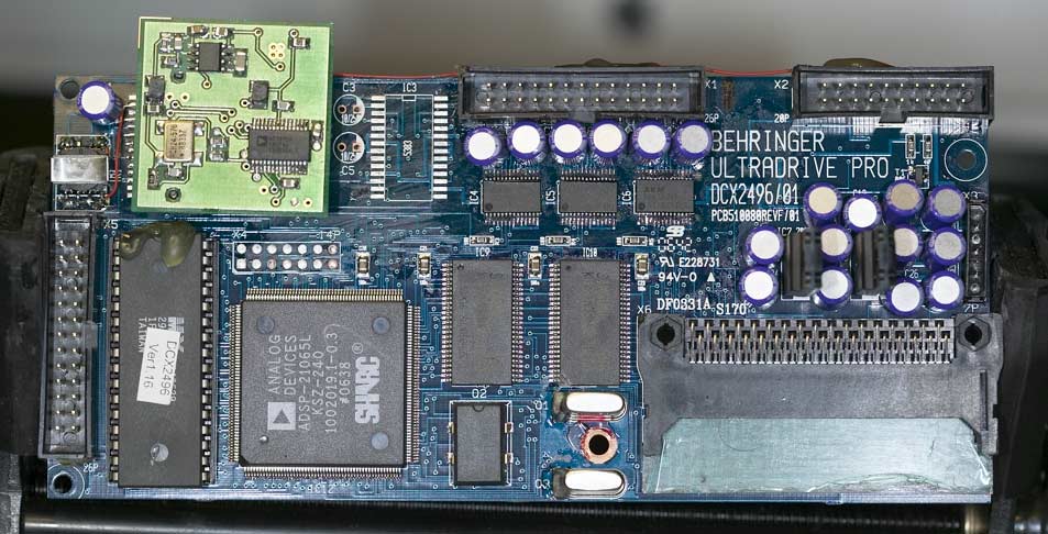

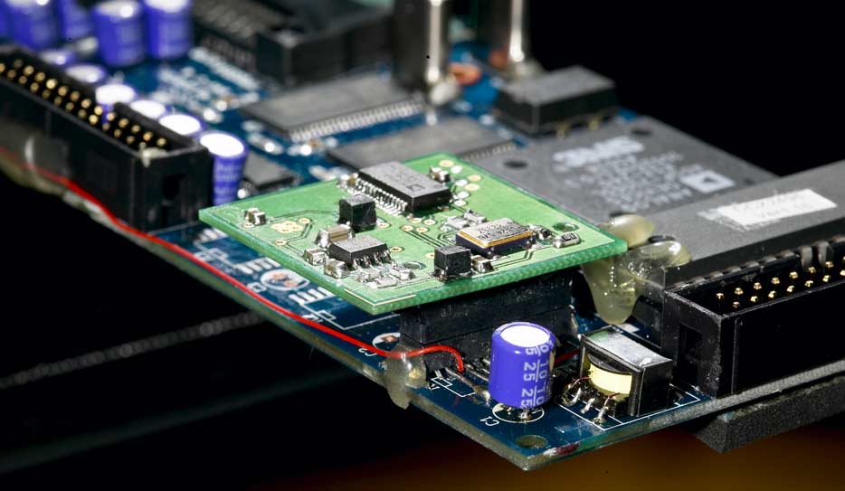

Next on assembly line was replacement of dreaded CS8420 input chip that has all kind of problems. I also wanted to do clock mod as well, I was for a long time thinking what are my choices. Than Frank Oettle came with his great small board that deals with both all at once. That is a small square board in the place of original input chip. Frank's board houses and uses CS8416 receiver chip, highly regarded AD1895 192 kHZ Stereo Asynchronous Sample Rate Converter, each with its own low noise regulator, and on the top of that Ultra Low jitter clock! Board was fine to assemble and it connects through connector to the board. Connector is soldered in the place of CS8420, only on one row, where few small wires needs to be connected from a second row. That was hard! Additionally one wire is needed to bring regulated 9V from power supply. I was also doing power supply replacement from Stephane who made great boards for DEQ2496. Unfortunately that couldn't work for me since Frank's board needed nice stable 9V supply. So I was back to original Behringer power supply.
Here is the picture of Frank's board. Red wire is 9V supply from power supply connector.
Next was listening test to check what it does. I was very curious to hear if all jitter talk is really something that makes sense or I would need to have special ears to hear the improvement.
It is understatement to say that I was blown away. I just couldn't believe that such a difference is possible. I would rate this improvement equal to analogue mod when I removed all opamps and replaced them with Lundahls.
What immediately became noticable was channel separation and imaging. The hole sound unfolded nicely and it had whole another depth. The voices are dead centered and instruments are behind on the sides. Highs are much cleaner and with nice detail. The grain was gone. I was just amazed that such a improvement is possible. I really would like to hear if everyone else who did this mod found the same improvement.
I believe that simplifying digital line, using low jitter transformers, and than Franks board that obviously addresses several issues that existed did it. I am trilled!
Thank you Frank - great board!
I would strongly advise this mod, as long as you are comfortable soldering very small SMD parts. Frank provides assembled board, but you would need to do connector and wires soldering.

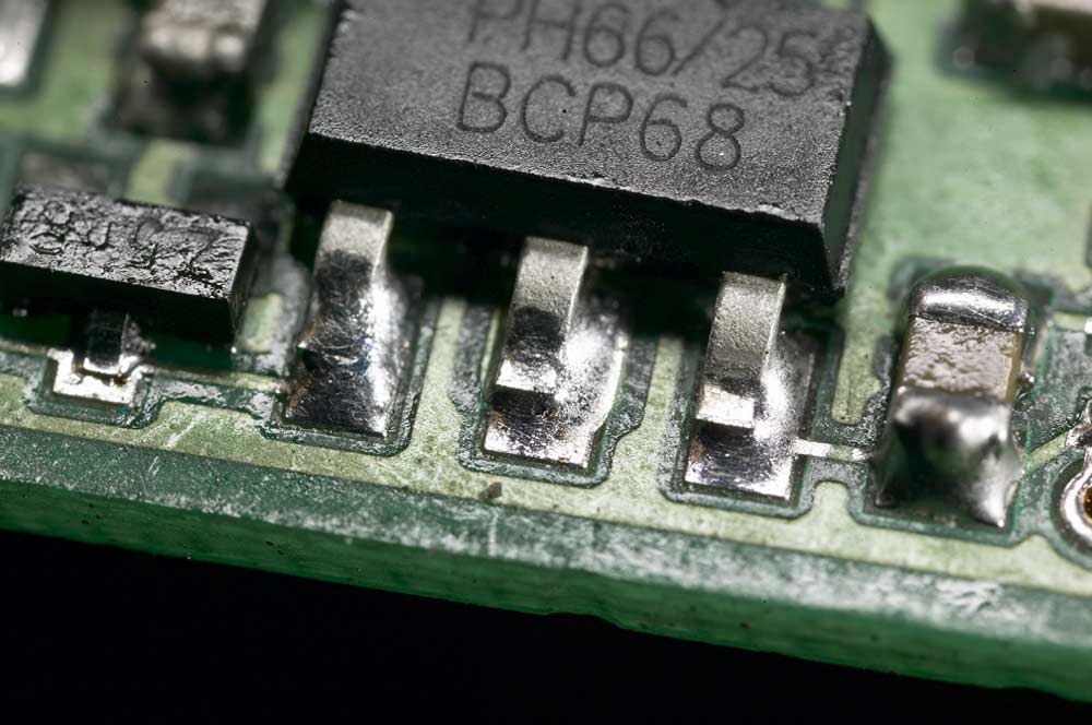

After all this while I was making pictures for you guys, and while I was inside this micro world, I made a really nice macro shot of a small SMD transistor that I like very much. That is bonus shot! It is amazing how references are exchanged with distances. Look how rough surfaces are in this small world.
I hope this walk through my mods inspires someone, but be aware you would need good tools and strong viewing aid for this micro
