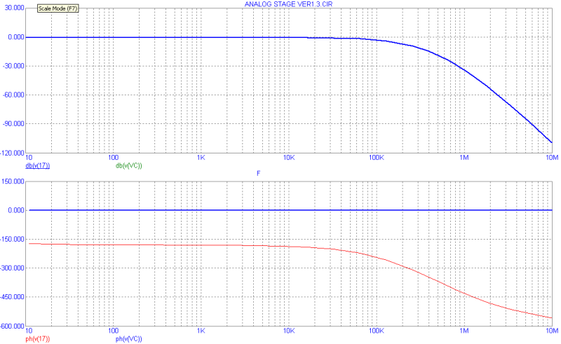

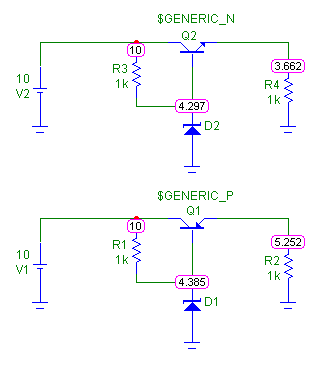

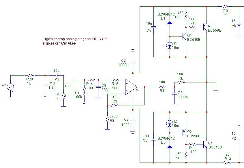

re your proto schematic;- the two transistor circuits appear to be shunt regulators. Are the driver transistors transposed?
You have three passive lopass RC filters in the opamp version of the circuit. Before you complete your sound quality analysis, would you care to tease us with the RC time constants while we await the outcome and final schematic?

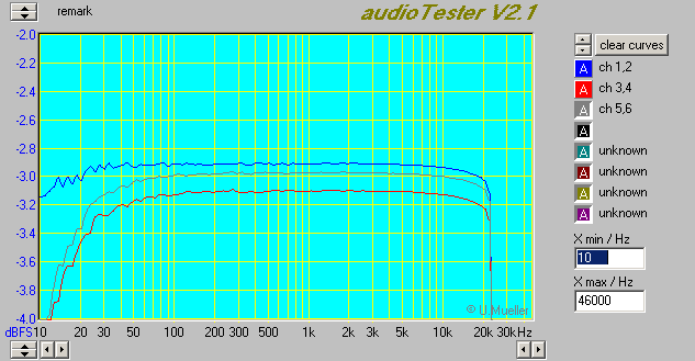

This is the actual measured output response from channels
1 and 2 - blue for bass C1= 47uF SilmicII
3 and 4 - red for mid C1=2,2uF film
5 and 6 - green for tweeter C1=2,2uF film
Note that the vertical division is 2dB total so actually @
20kHz the response is down only -0.2dB
Ergo
Ergo
Thmartin said:Hi Stefano,
Unfortunately I haven't the schematics of the DSP8024, although I owned one in the past (replaced with a DEQ2496 now).
I reckon it should be a lot different from the DCX as is doesn't share the same DACs at all.
Now, back to the DCX2496 : I am working on a separate power supply for the analog stage of the DACs (5v analog) because I really do not like what Behringer has implemented there
Have a look at this : Power supply
(sorry about the french, when I have time I'll translate the whole site) :
Good luck,
Thierry
http://thierry-martin.9online.fr/tweakdcx/5Vdcx.gif
4.3v Zener and Vbe drop dont make 5V , it would make more like 3,6v...
