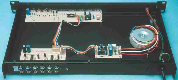

The Silicon Chip K5600 6 channel remote volume control
is still on special at Altronics with a rack
mount case. Specs look fairly good. I bought
one and will update the TL072s when I get round
to assembling it. Have not got the cash for the
DCX yet but will have to attenuate the DCX outputs
which I hope will not be an issue.

Anthony,
That is an interesting unit! Is that price in Aussi dollars?
Do you have any info on how it works, solid state vca or mechanical pots?
Jan Didden

janneman said:
Thanks Anthony,
I just downloaded the article part 1. Nice! This may not be the most-fi unit available but for that price it may help me to get into multichannel-issues while developing my own 6 channel control. I have to see if they will ship to Europe.
Jan Didden
Jan,
All the info/schematics are available on the DCX forum. Look at the top of the files section. It's been there for awhile.
http://groups.yahoo.com/group/DCX2496/
Davey.

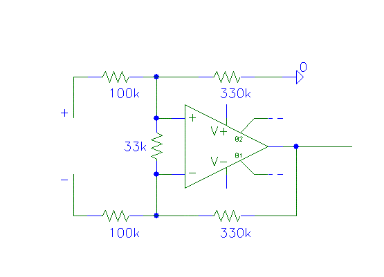

Is there a way to maybe modify the gain on the analog output stage so that it outputs a weaker signal? The gain is to high for my chipamps and i dont want to put attenuators in the signal since that will alter the highpass (dc blocking) filter on the input stage of my amps.
Hi Akunec,
do not worry about needing high attenuation after DCX for a following high gain amp.
A low attenuation level requires a series resistor only slightly higher than the ground resistor. This leads to a high output resistance (impedance).
A high attenuation gives a low output resistance due to the NEED for a low value ground resistor.
This falls exactly into what YOU need - high attenuation AND low output resistance. No problems.
Konnichiwa,
How about you re-build your chip-amp's with a balanced input and a gain set such that you get a direct match between the DCX clipping and the Chipamp clipping?
Sayonara
Konnichiwa,
akunec said:
Does the DCX clip at 5v?
+22dbu = 9.76V
akunec said:
So since the chip amps clip at 25v, ill need a gain of 20log(25/5)=14db. Does that sound right?
You need to do two things. You need to change the input to balanced and you need to lower gain to what is needed (I'd say 10db), BUT the LM38XX series needs at least a gain of 10 (20db). The way around this is a suitable value resistor between positive and negative input to ensure the (noise) gain referred to the positive input remains greater or equal to 10.
For a balaned Input you take a pair of 330K Resistors, one as feedback resistor, the other from the positive input to ground. You then use a pair of 100K resistor to the respective inputs (+ to pin 2 and - to pin3, pin 1 of XLR grounded). To make sure the noise gain is high enough, con nect a 33k Resistor directly across the + & - input pin on the LM38XX Chip.
Like the attached (not tested but should work fine...).
Sayonara
