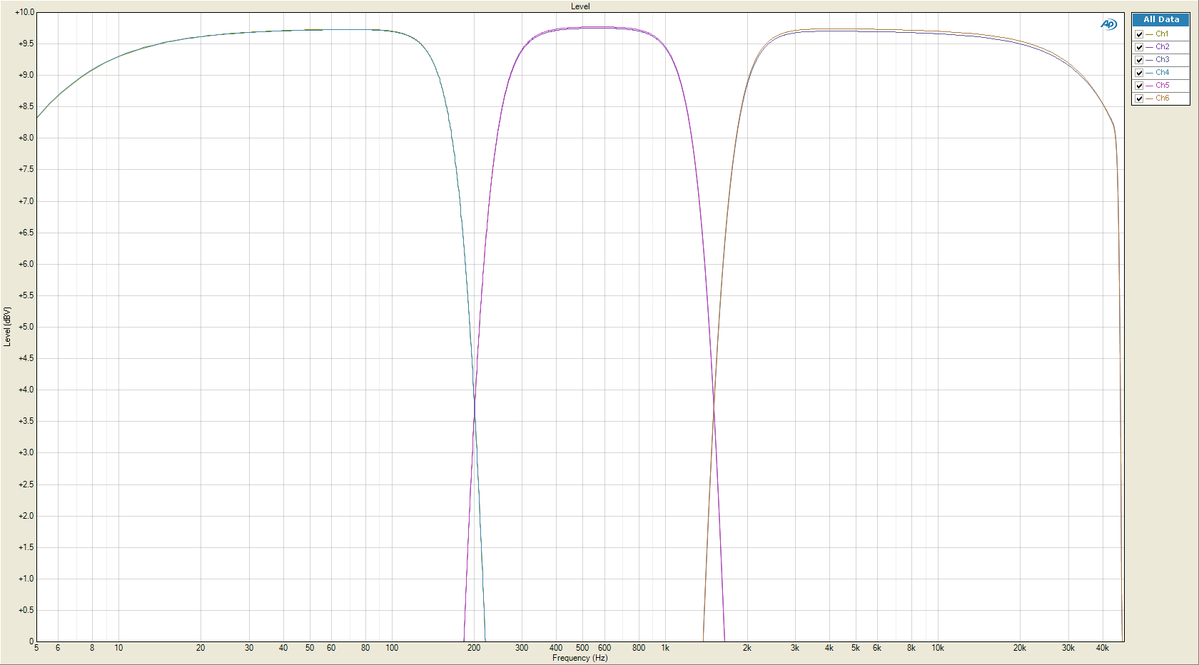

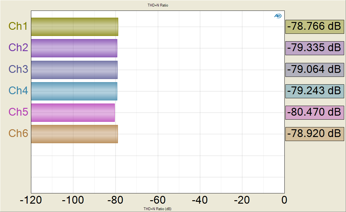

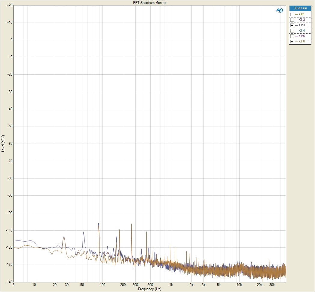

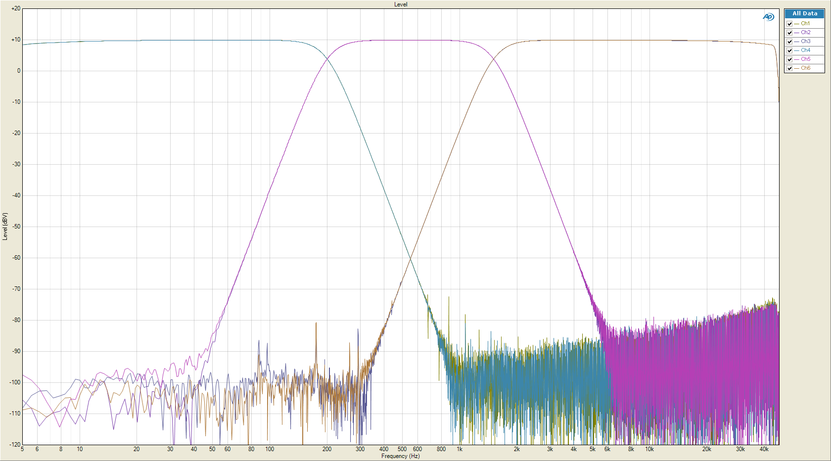

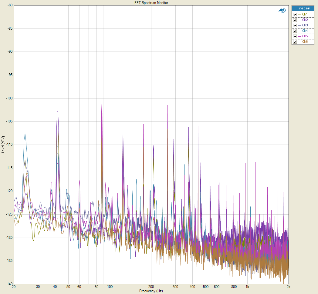

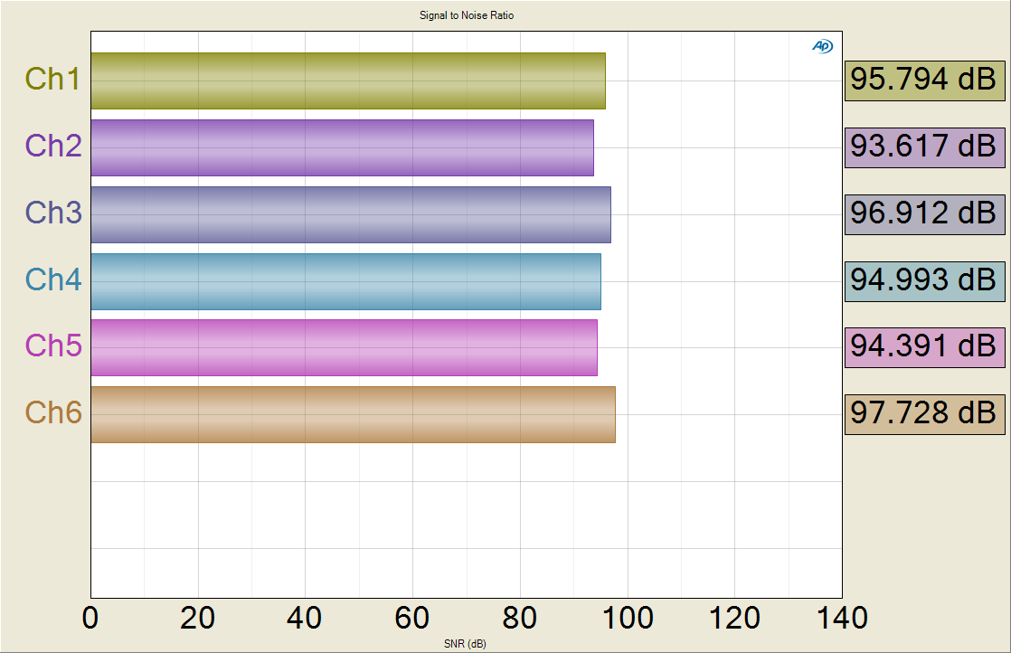

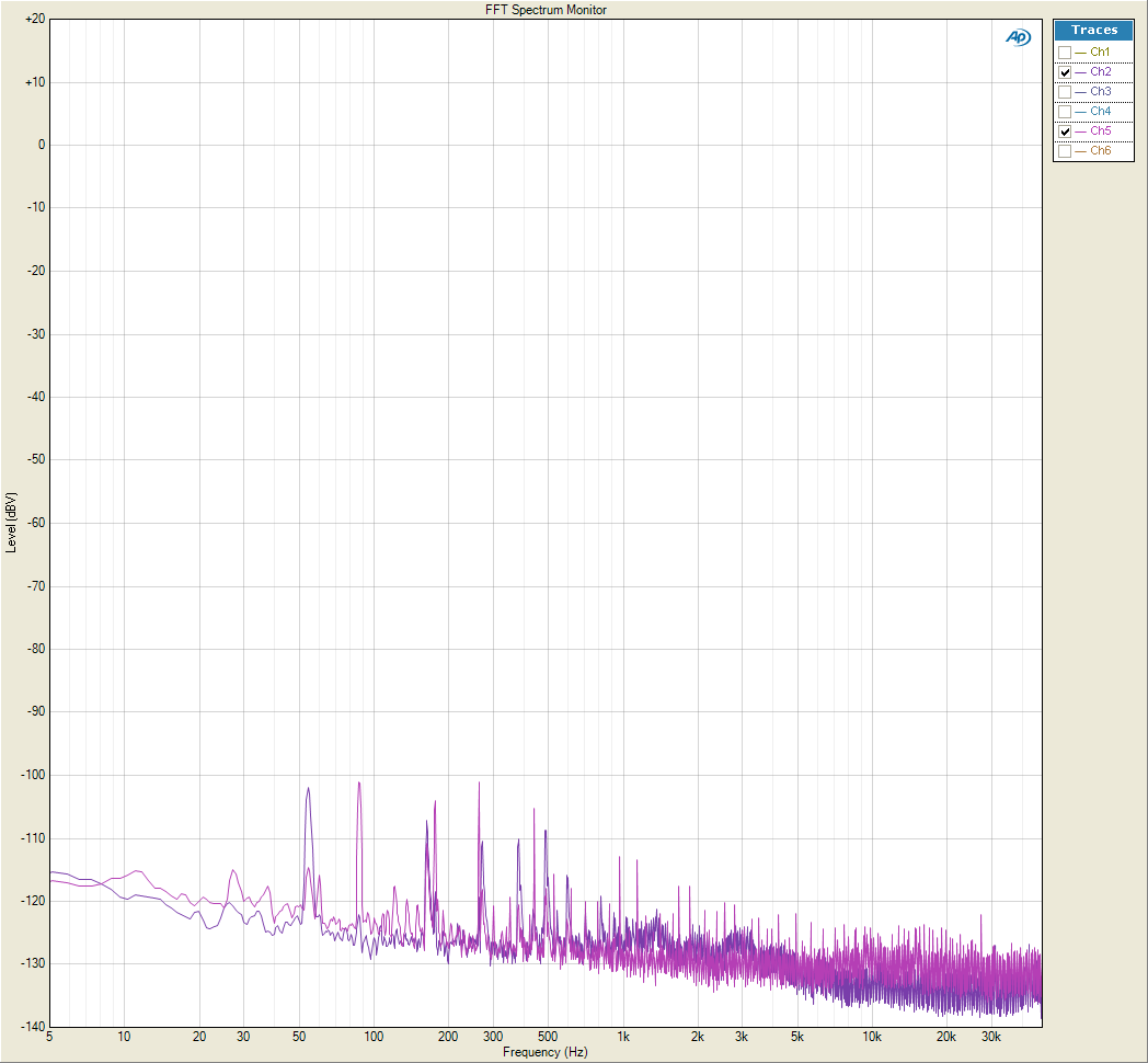

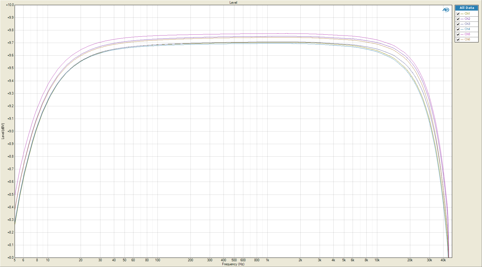

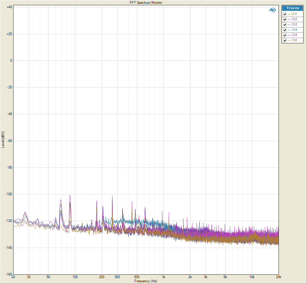

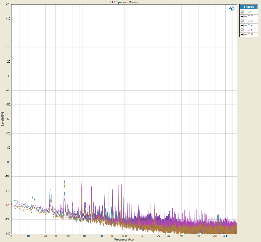

While we're on the topic of mediocre performance, I've attached all my "baseline" measurements below. This is a bone-stock DCX2496 measured on an APx585.
Pretty much everything is buried in there somewhere. I didn't do THD vs. Frequency but I'll run those a little later before I modify anything.
I'm going to start by tearing out the entire SMPS module and replacing it with a fully linear supply using a separate PCB mount Amveco toroid for the digital and analog sections. I'll be using TI's TPS7A4700/3301 ultra low noise regulators pretty much everywhere. I'll make a pair of little break-off PCB's to replace the two on-board linear 5VA regs, and replace the 3.3VA reg with the same sort of thing but soldering that might be a little more tricky since it's derived from an SMD transistor.
I expect the above to clean up the noise floor by a large margin, along with moving the AES/EBU input away from the analog signals and direct wiring it to the isolation transformer.
I'll report back with progress.

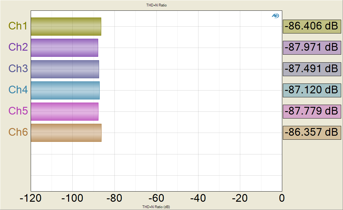

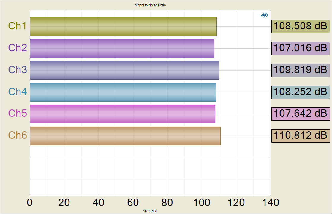

and... a few more measurements as I hit the limit on the last post.

Might be these measurements are helpful for you:
Ergo Audio :: Stock vs. modded
unfortunately IMO they reinforce my point more than anything....
Holy Jitter Batman!
That last measurement is unbelievable... Perhaps that helps explain why the stock unit gets on my nerves so badly.
I'll repeat a jitter test on mine as well before making any changes.
This is part of the reason I'm worried about IC19. If it's responsible for that level of jitter, then I get the feeling it's easier to just start from scratch with something like the miniDSP SHARC.
oettle:
What exact changes would you say were responsible for the reduction in jitter? You have improved it by a large margin, but I would still say that it could use further improvement.
From your listening, was the jitter reduction a significant improvement sound-wise? I'm not of the mind that every ps of jitter is audible, but when jitter artefacts clearly extend up into the audible range as they appear to in your last measurement, I would expect them to be audible.
Also, it appears from our measurements that the old PS was quieter than the new PS. Our stock measurements vary by quite a bit.
Owen

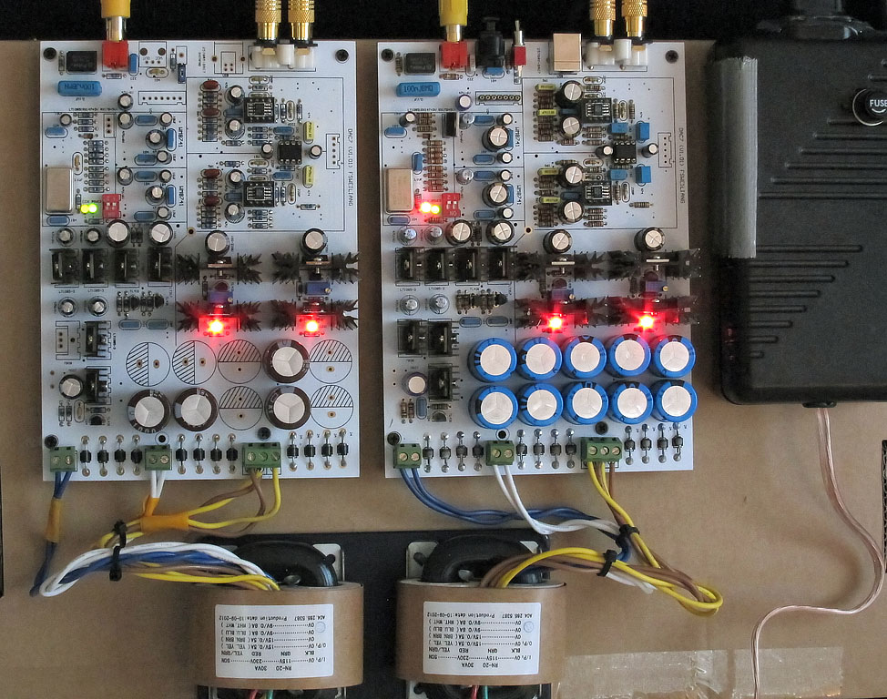

I'm using 3 of these trainwrecks and I’m pretty happy with them. To my experience there is nothing wrong with the DSP, the ADC and DACs. The rest can be modded. So you end up with a price which is about twice the original price of the DCX which is still very cheap. There are much more expensive solutions out there which are not necessarily better.
I picked up some cheap ebay dac kits (one built, one truly a kit) and they are setup with the behringer now in some really deluxe mounting
for diy guys, having spdif out really is a fun thing to have. I can try these dacs for a bit, hack on them, maybe try something else later if I want.
(these are dual-mono wm8741 with wm8805 receivers, all underneath the white boards).
I will do a measurement of these, later on, but sonically they blow the onboard analog-out system (including its stock psu) away.
the dual mono config of these ebay dacs is also kind of a fun detail, to me. each dac chip now handles its own speaker. left/tweeter gets its wm8741 chip, right/tweeter gets its own. no one has to share
the wolfson chips have a 2db cut feature so you can't overdrive them when 'near 0db' levels come in (which happens hourly on many internet radio stations that I listen to). I don't miss 2db, but I do hate harsh clipping (a lot of cheaper modern dac chips do NOT handle gibbs issues well).
its also really nice that I no longer have to deal with the ultra hot 22db signals that come from the behringer analog-outs. those were really too strong for the cirrus vol control chip I use and I hated having to atten so much just to interface with them.

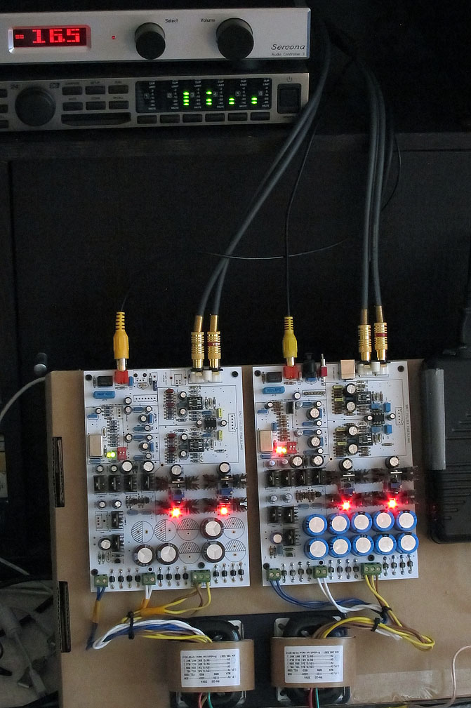

Well done liuxworks. Congratulations!
I think your solution is a good approach to replace long analog cabling between DACs and power amps. Also the onboard clock oscillator might have a bit better jitter values than the poor DCX crystal circuitry.
For short cabling it is worth to think about passive analog outputs or Jan’s active outputs and about a low jitter clock instead.
Keep on modding - it’s fun!
but with the 'dac-sink' (half dac, half heatsink, lol!) sitting on the floor, I've swapped long dcx analog cables for long dac analog cables. heh.
I still think the cirrus transmitters would be easier to use since they don't need any local crystals. otoh, if removing the tanks from the wolfson still lets it work, then it would be an even draw between them.
the 8420 will have to be looked at next, I guess. everyone complains about it, so perhaps it does have to go
