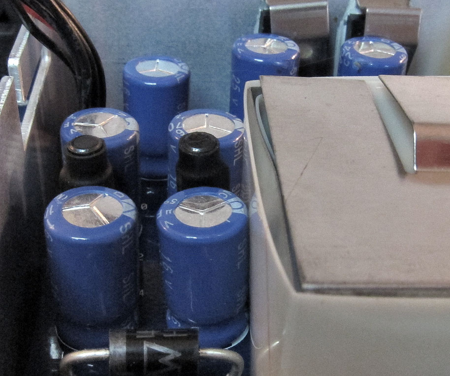

related: last nite, my deq2496 blew itself up. it was powered-on for months at a time (probably half a year or more) and just always left on, along with the dcx2496.
powering it off to swap in some new equipment in my main rack, then powering it on causes this cap to blow enough to stop the unit from coming on. cap is bottom/left. just bulged enough to not work.
sigh.
luckily, the damage was not far and it seems that by replacing this bad cap the unit powers on, the display comes alive, filters work and aes3 in and out work. that was a close call!
just about a year after buying it, brand new, too.
oh, and the top sticker that had its production date or code said '9/11' on it. (uhm, lol?)
anyway, if you are outside your warranty period, its probably a good idea to just replace ALL filter caps in your behringer boxes. I don't trust their parts selection (not that I ever really did).
